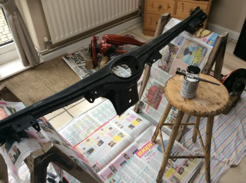

The other trailing arm primed today. Just the beam , ARB and lots of little bits to prime now ....then do them all again to finish them in black :arghh:

Next on the production line. Might paint it tonight once its been sitting in the warm for a few hours.
Wont paint the ends though as I think it has to be heated to get the new bushes in.

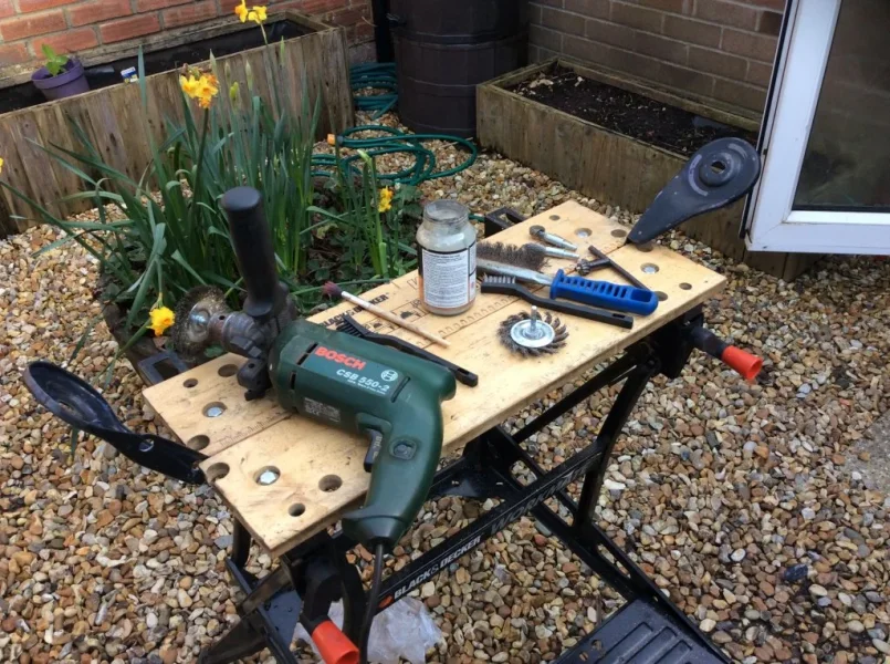

Outside this morning in the sun for about 3 hours de-rusting and treating all the small bits. I must be getting used to it as didn't mind the cleaning today............or was it that I went into Zombie mode??????
All these bits now just need painting with the red oxide then black top coat.
The nuts on the top of one of the trays are for the beam and trailing arms which will have to be replaced.
The washers are from the differential fill and drain plugs and also need to be changed , but luckily got some spares of these:)
By the way I don't have OCD......but if I don’t keep it all separate and labelled, I will be in sh*t street when I start putting it all back together:D
The beam brackets were in amazingly good condition just a small bit of surface rust on the edges.
