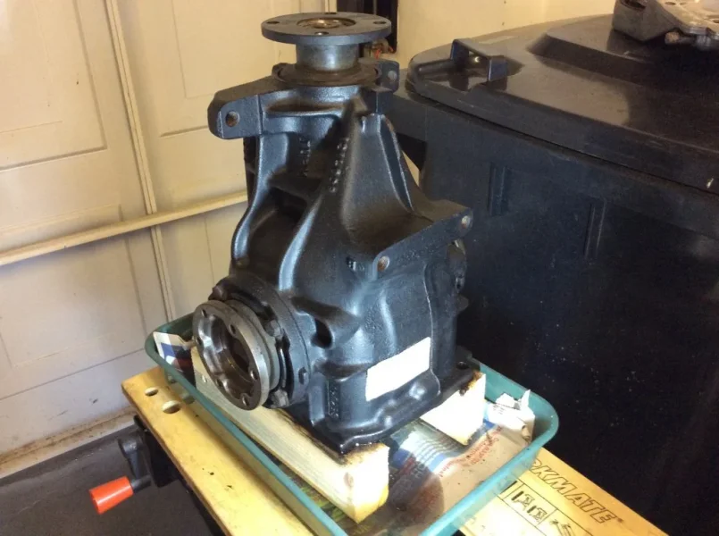

But did paint the diff.

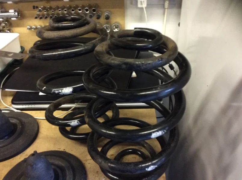

Springs look reasonable, bit rusty one end, but they are slightly different heights ( 5mm difference) so thinking they should be replaced.

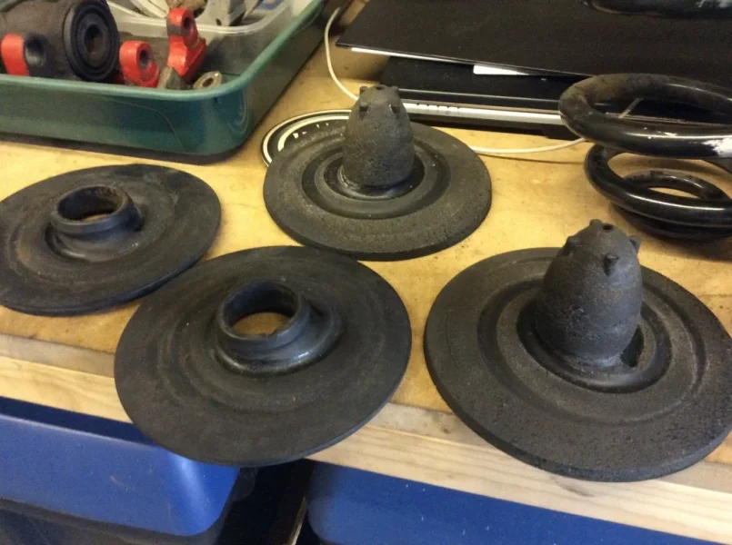

The spring plates dont look too good so think they need changing.
And can someone confirm if these actually come with the new shocks?? I removed them from the lower end of the shocks in case they dont.

Those lower shocker sleeves should not be loose Malc. There will be sleeves in the new shockers.

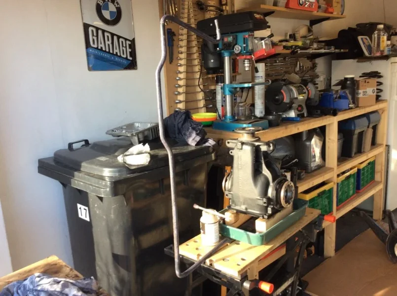

Wire brushed both trailing arms, the ARB and the beam.As the beam was still outside I gave that a coat of rust treatment. After 4 hours of this I had had enough :whistle:

Did all the rust treatment to the trailing arms and the ARB, and with the ARB drying so quickly did a second rust treatment primer coat. Missed a couple of spots on the beam so went over them as well.
I had a good look at the springs and it appears they are different makes. But they dont seem too bad so I will clean them up.
I have ordered new ones anyway so they will be replaced , but I will get Lees’ opinion on them and if useable then they might get someone out of trouble so could possibly leave them at either of the Zedsheds for any emergencies.

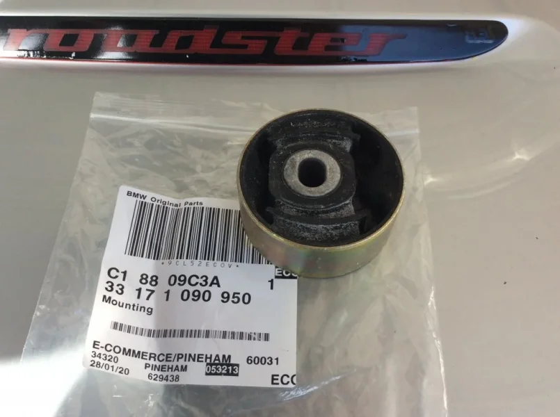

Postman arrived with a parcel, which has left me a bit confused.....
The part has come from BMW Park Lane, and its the Differential bush, but the middle seems off centre.
It this how they should be ???????
In the pictures I seen the bush always appears to be centered!
The only thing I will do later is turn the ARB round so I can prime the bottom end....but that will be all for today.
