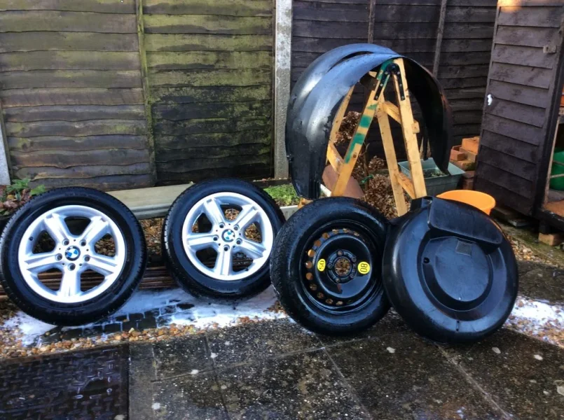

Then I will have to clean the Diff , Trailing arms, Beam, ARB, plus the wheels , and the arch liners which I still need to remove from the car, and the spare wheel and carrier........OH JOY !!!!!!

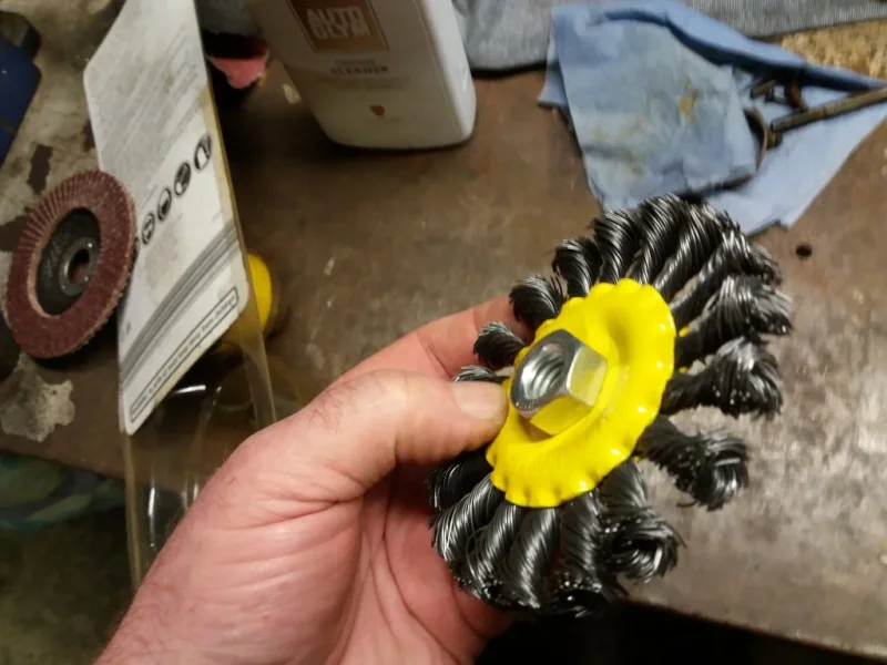

I have an old Bosch corded drill for wire brushes plus a corded angle grinder for sanding discs and pads. Hopefully should be enough to get it all done.
  • Like
Reactions: Lee

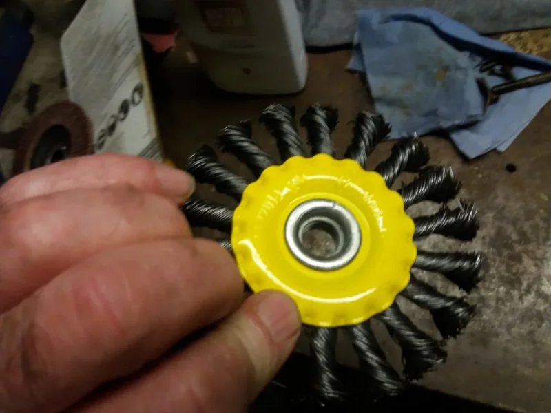

These make short work of cleaning Malc. They screw directly onto the angle grinder and are very effective. You will need the side handle too. Far better than using a drill, much more manageable.

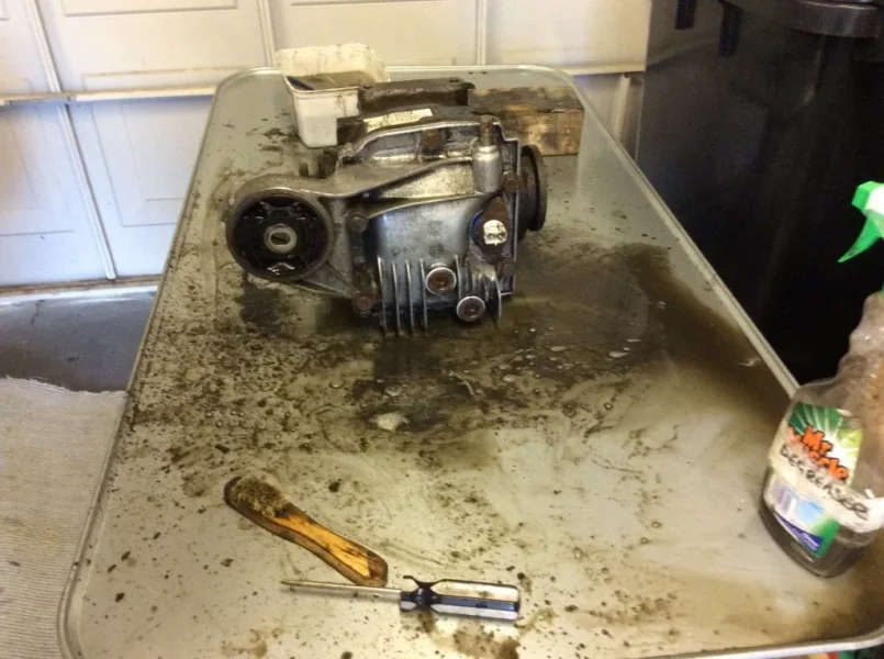

Happy days ...or it was, till I realised I had cleaned it all up and not done the diff :arghh::arghh:
So got everything out again and started on the diff, and it turns out the rear plate is silver in colour:eek:
At this stage I had reached my cleaning boredom threshold so decided to stop.....after all it will still be there tomorrow:whistle::whistle: When I can finish the diff and then clean the beam. :arghh::arghh:
Everything metal wise is in pretty good condition, (back plates / trailing arms / beam) but the trailing arms have at some stage been coated with something to protect them, which unfortunately in places has come off so led to some surface rust, and quite a few areas where it is bubbling so obviously has water trapped . I think my best bet is to take it all off and treat everything.
The bush on the diff looks fairly new but it is starting to separate from its outer ring, so while its out and for the minimal cost of a new one, I’ll change it. Any suggestions on best way to remove it without damaging the diff mount gratefully received :thumbsup:
