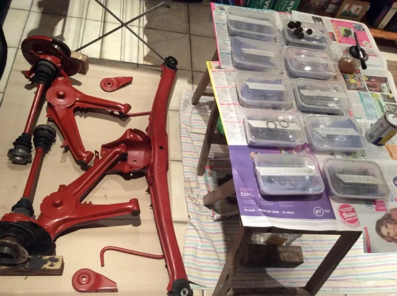

Failed to do any painting , but did have a tidy up ready for tomorrow :whistle::whistle:
Go through all the little boxes and see what needs painting. Might as well do all the red first then do all black top coat later. After all no point in rushing......mind you if I was going any slower I be going backwards:eek::eek:

Its cold and chucking it down outside today, so sitting in the warm, watching the tele, and painting.:)
Might as well make a start as it will take a few days to get all these bits and pieces done.
I have cleaned off all the threads of the bolts with a small wire brush to make it easier when it coms to reassembly.
Any nuts that are being reused will have a tap run through them as well, to clean any crap out.

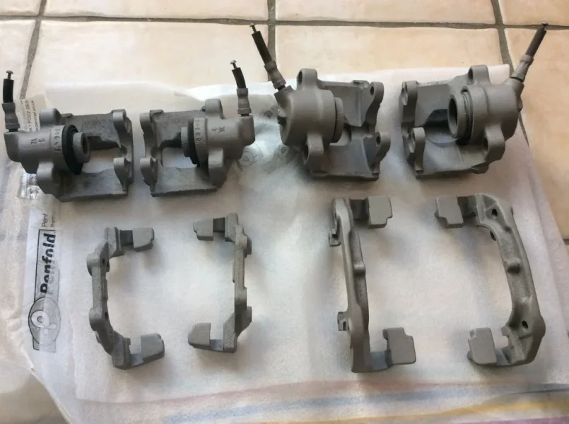

I really have caught the cleaning bug........
From this.....
To This.....and so simple......
.........Get someone else to clean them =))=))=))
Dropped them off at 11.00 this morning and picked them up at 3.30 this afternoon.
Just need to get some primer, then red paint on them. It will have to be brushed rather than sprayed though....even I draw the line at using spray paint in the conservatory :)

New parts ordered to do refurb on the callipers, but in the meantime a spot of painting
I suppose I will have to do the new discs as well to match. :eek:
