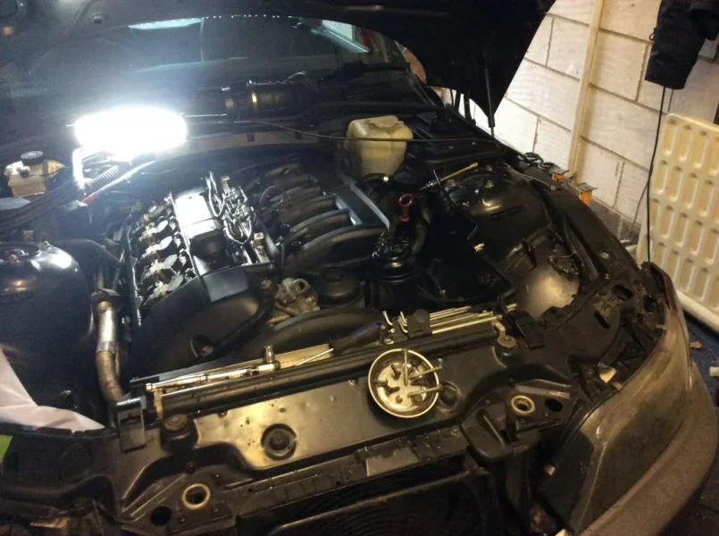

Then after Trev and Paul got back...and coffees’ consumed.....Lee started on his car, replacing some CCV pipework ( all located under the inlet manifold so not easy to get to)
Now thats an engine !!!!!!

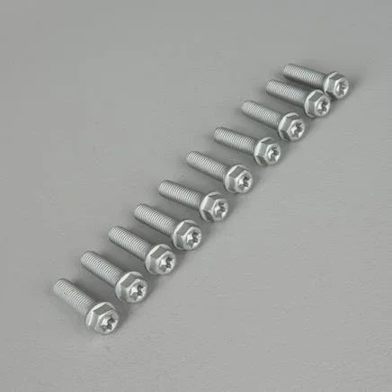

I did find out this morning that the recessed Hex screws that hold the Beam Plates (the screw of doom:ymdevil:)
are no longer available. Plus BMW dont have an alternative. I was going to change mine ( recommended ) but now not sure what to use in place of them.

Malc the hex recessed screw so called screw of doom, is this something that can be machined from an existing hex bolt or is it worth getting some turned up, or is this something you leave well alone your thoughts please. (as I know of someone heading in the same direction as you) :whistle:

I may have found a torx version m8 x 25.
Same head shape, and the 3mm extra length shouldn’t matter
Just getting confirmation that they will be ok to use. If so, I will order ASAP and as they come in packs of 10, and, as I only need 4, this someone you know may be in luck :):)

I replaced mine with normal 8mm bolts

Thanks Malc, that’s brilliant :thumbsup:
