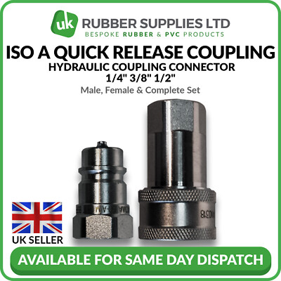

Like the quick release coupling, where did you source them from, got a link?
A friend I used to work with gave me it Col but this is what you need,
If it’s the same as mine you’ll need a double male 1/4 BSP union too.
