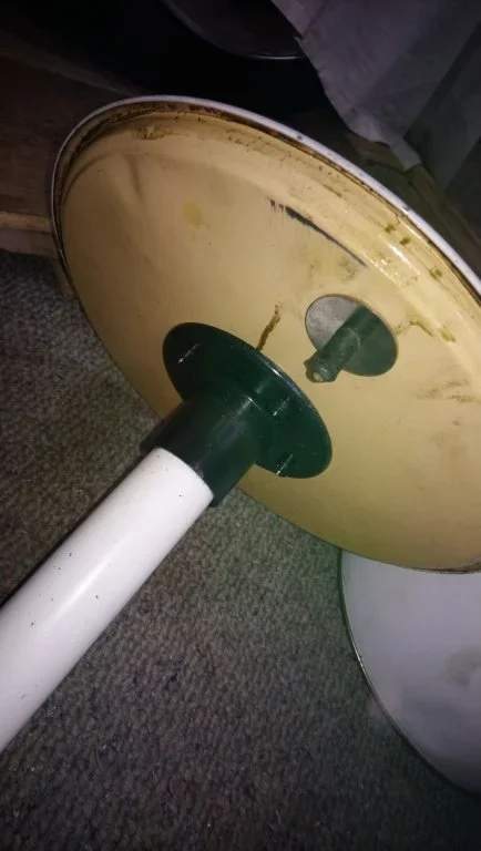

That don't look very stable Col.;) What did you use to allow air out of your drainer please? I'm thinking of using a 1" rubber tyre valve glued into the top and remove the Schrader valve and just fit a cap on it. What did you think to moving the lift on a trolley jack? So much easier to pull/push it around.

Opps forgot about the air bleed response, as mine is a metal can was thinking of putting a lever ball tap valve as used in plumbing in the lid. Metal tyre valve with the core removed also considered, since your tank is plastic maybe the rubber tyre valve would be the way to go.

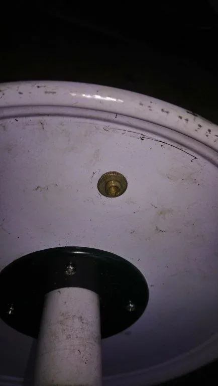

Sorted the air bleed for the oil drain used a tyre valve cut from a motorcycle inner tube fitted to lid of the can secured in place using the metal valve retainer, core taken out and fitted a metal valve cap as the seal, just take it off when in use.

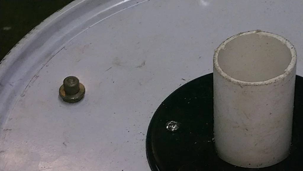

I went to where I used to work and scrounged the shortest tubeless valve they have (1"), took the valve out drilled a 11.5mm hole in the drum above the main cap. I got a piece of wire and bent the end to stop the valve sliding off the end. I pushed the end of the wire out through the 11.5mm hole ready.
Applied CA glue to the rubber and a spray of accelerator to the drum. Then pulled the valve up through the hole and screwed on a metal valve extension to which I attached a pair of grips and pulled the valve rubber through the side of the drum. Removed the extension and the piece of wire and job done.
Just needs somewhere to store the cap when removed for use ............
