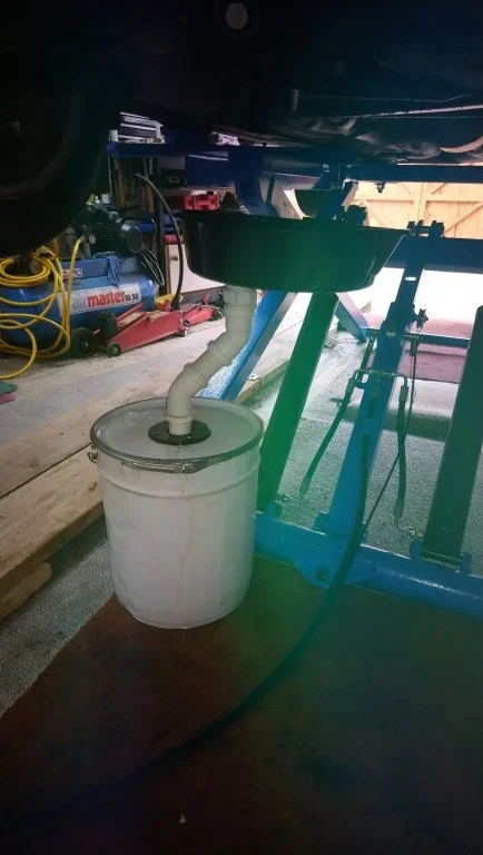

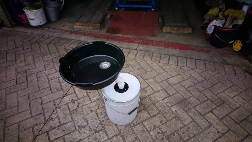

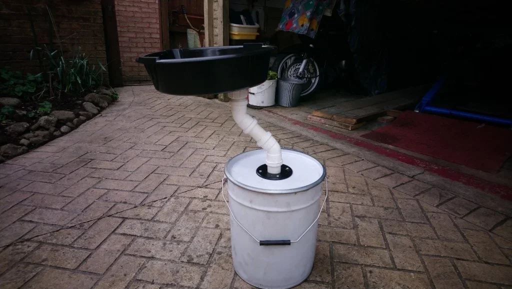

Looking at putting a ball valve tap in the lid to provide the air vent, maybe mount it on some wheels like Tony did to his. Not bothered about a sight glass don't intend filling it up completly, waste oil will be taken to the council tip recycling tank. Can take the upper pipework and tray by pulling them from the push fit fitting, have another push fit fitting with a sealable cap for transport and emptying it, just pushes on where the upper pipework comes off.After the wheels - a sight glass, an air vent, a neat method for removing the tube without getting oil drips and maybe a neat storage with the basin removed (or is the basin removable?).
