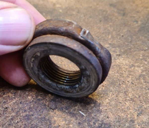

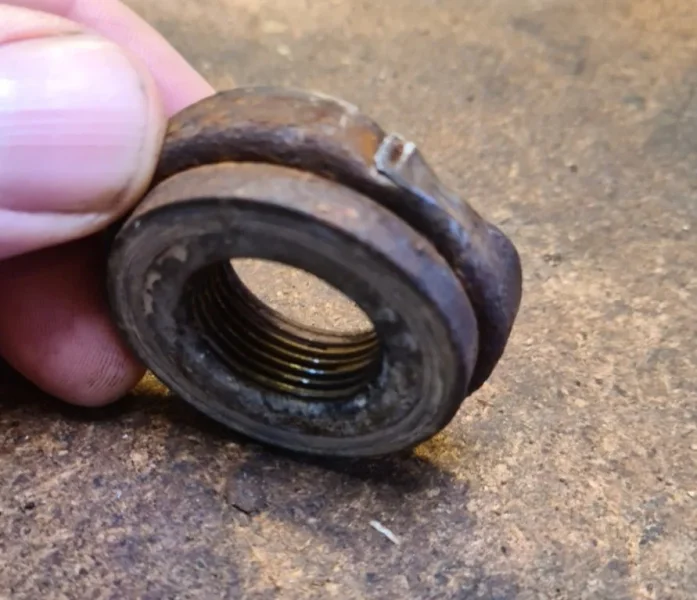

decided to brave the right hand hub with the nugga..... this time with the RIGHT SODDING SOCKET !!... a 30mm......... aaaaand....this one....came off like a dream

@DrWong ..definitely...the other side did put up a fight..the socket was stationary for a while as the impact was smacking it, then slowly started turning then started to whizz. what I failed to appreciate is that nut is a top hat nut and not a normal nut, so all my banging and drilling was only going halfway down to the washer and not through the whole nut...I'd actually go as far as to say don't use an impact on the hub nut, as even with the right size, it still rounded it off..

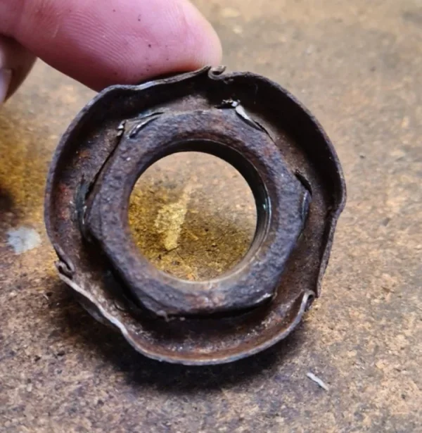

well as @Andyboy has indicated I had been a prize plumb and forgot about the locking ring !.. I'm using the excuse it was so covered in rust I didn't see it :whistle:
however, I spent a number of hours chiselling out every remnant I could muster... this is what I chiselled and hammered out compared to the other side
So I'd gotten to the point after several hours.. that I could see the shoulder of the nut all the way round but it wasn't budging
so next course of action was to let it cook on a Gas Mark 6..... while I went to get a Gin....
more hammering.... but no bueno...... I'm now thinking I might have to sacrifice the drive shaft in order to hammer it out from the back :rolleyes:
