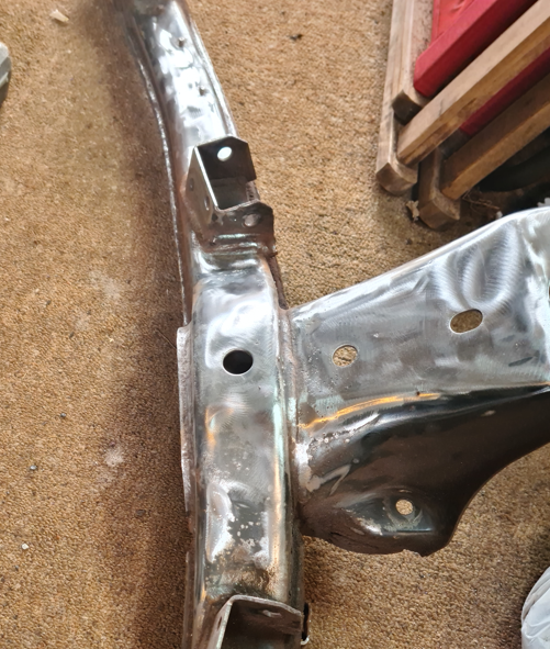

so Bank holiday Saturday... so it was time for a little bump and grind !!
Decided to start grinding back the subframe with my new angle grinder, poly discs and knotted wheel.... yes I know you don't have to go back to bare steel but I was having fun playing....:D
it's coming up really well..... though I'm not sure if someone has been here before.... don't think that's factory weld spatter !
