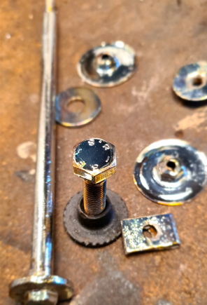

did a bit more plating .... it's primarily a four step process and I'm happy to do a tutorial if anyone needs one..
so this little lot are some more heat shield fasteners, the petrol tank bolt and washer, and the Spare Wheel carrier pivot bolt and nut.

The zinc plating looks really cool :thumbsup:
I've used electrolysis before when I was restoring the rear subframe to get the rust off which was very effective but I haven't ever tried plating.
Great way to restore all the hardware without having to spend silly money on new nuts and bolts from BMW.
What is the cost out of interest for the material you need?

@Faheem .... I got my kit from Gateros .. basically went the whole hog for Zinc plating, Ultimate kit including the variable power supply which is SO much easier than using say a battery charger... it's about £190 but well well worth it... https://www.gaterosplating.co.uk/product-page/zinc-plating-kit

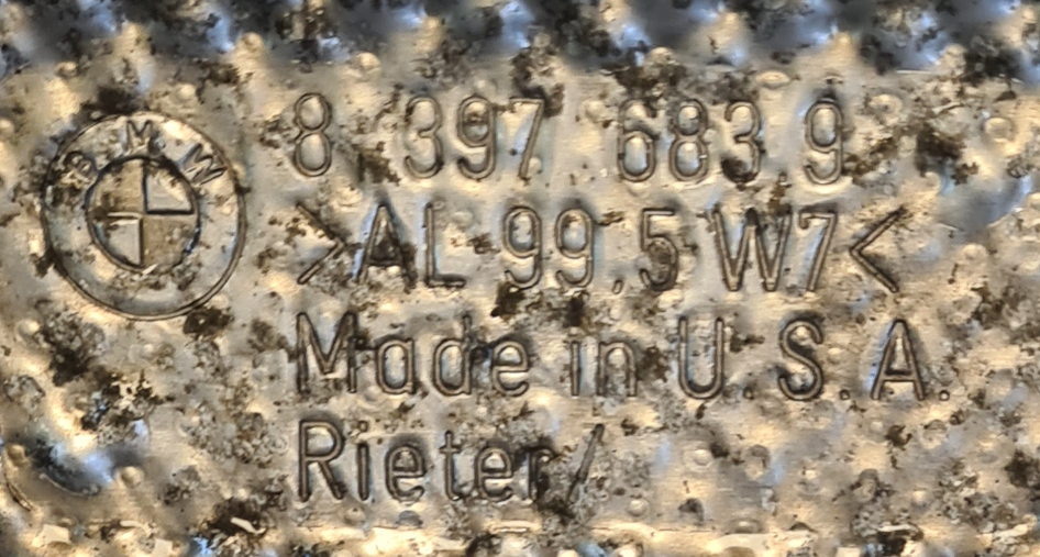

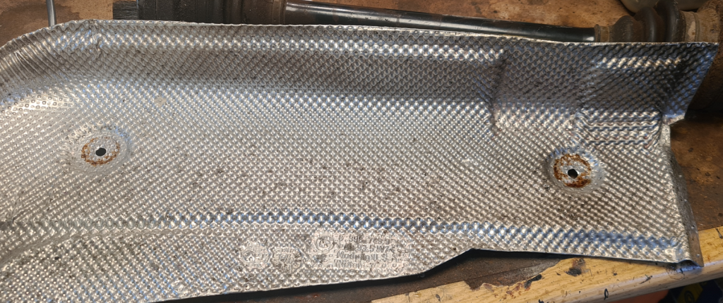

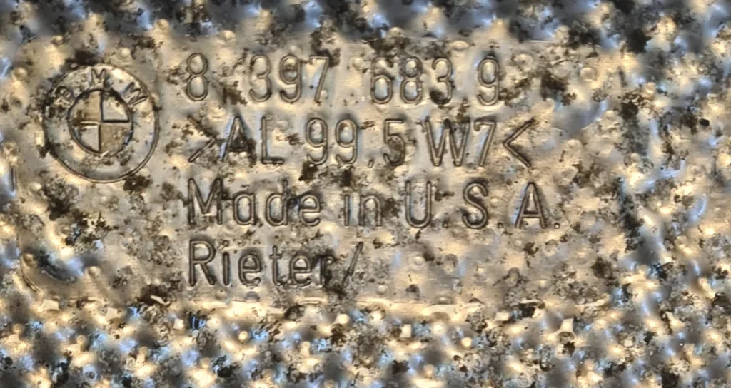

I also cleaned up the VERY grubby heat shields...…. just sprayed on alloy wheel cleaner and let it do it's thing (turning purple), then got in there with a stiff brush using jabbing and rotary actions.... then hosed off with the Garden hose....
This is the number in case anyone needs it...

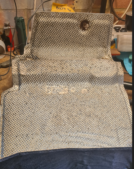

Same with the other two...….quite surprised to see rust., and some of the fixing holes had actually rusted through. I'm no metallurgist, but that's clearly not aluminium !
and the last one...

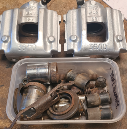

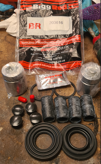

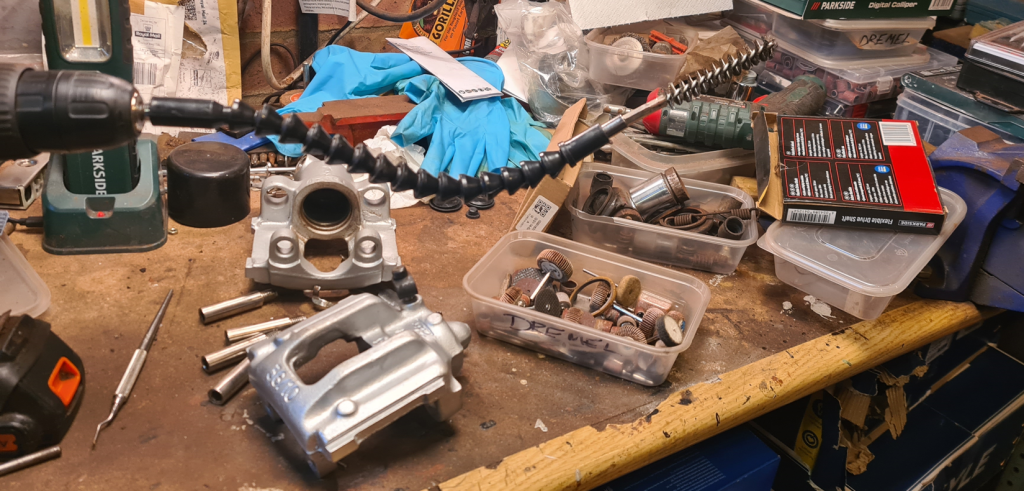

well today ha!... was supposed to be the simple job of building up the calipers.... until I hit my faux pas.
First job was out with the old and in with the new,,,,,

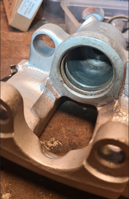

I then cleaned out the piston cylinder walls with my flexible drill attachment and pipe brush.... also great as an enema ! =))
net result, lovely smooth bores...
I did have designs on zincing the pad springs, but as they are classed as "consumables" then maybe not.... came up well with the Dremel and brass wheel mind you !

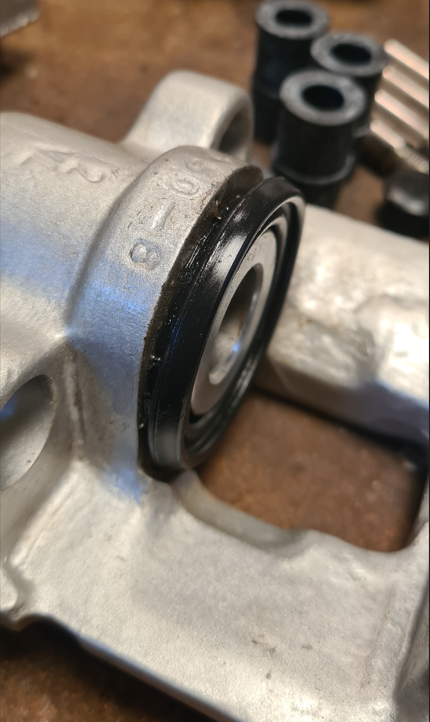

Got myself all together and greased up the piston and boots.... confidently started winding it in before I realised the the boot clips on the INSIDE...as Z3 Calipers are different to E30 ones (that clip on the outside) I had completely missed that Z3 calipers don't have a shoulder for a snap ring.
And now my Faux Pas.... I can't get it back out... felt uncomfortable trying to feed the lip in with a screwdriver, so I need to get a foot pump as mine is buried somewhere and like @Mazza fashion a hose that will clip onto the pump to pump it out.
Now, assuming I do get the piston out, how the hell are you supposed to get the boot clipped to the inside ? I guess you push it it halfway down the piston so that the bottom is free and you can feed it into the groove ?

Cheers mate.... I've seen Malc's vid ... but I need to find my pump before I can make up an adaptor hose 😆
but I still don't see how you clip the boot in without fitting that first and then trying to install the piston afterwards
Lubticate the seal well with clean brake fluid.

so do you put the boot on the bottom of the piston, feed it into the groove then try and push the piston in?... like an idiot I just thought they were the same as E30s
Like this! When it comes to fitting the slider sleeves, I fit the other end first. I find it easier.

thank you @AntStark and @t-tony .. that's perfect...I might just be able to wedge the lip in with a plastic trim tool with the one that's already got the piston in...but I'll try and fashion a way to pop it out with a foot pump and try again..thanks guys!
