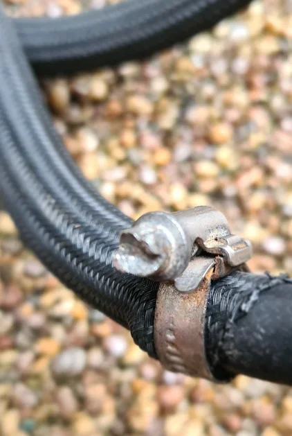

first job was to remove the old fuel pipes.... not helped by the slotted heads being ruined and the nut heads rounded off by a previous "careful" mechanic so it took half an hour to get them out...not going to fit the refreshed fuel pipes until I get the "double ear" fuel clamps, arriving at the weekend

The reason those small jubilee type clips are spoiled is because previous people haven't used a 6 point 1/4" drive sockets to turn them. A flat blade screwdriver does work, but only for so long. Any clips with a hex head needs to be turned with a socket.
exactly....every one of them was completely trashed. Trying to get them off from next to the engine turning about 2mm at a time was joyful
1/4 drive socketry is the thing to use.
Do they fit the new clips? If not buy one that does before you use them Matt.
I meant buy a socket that fits the clip hex heads properly before using the clips mate.;) Using those 2-ear clips is ok if you don't intend removing them in the future, but if you do then they are not what you need.
OK, just make sure it's a good fit. Mostly they are 6mm hex.
cheers Tony...yeah I have dozens of small sockets..I couldn't hammer one on as the dipstick was in the way, so gently teased with a screwdriver
