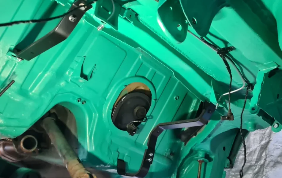

ok so only a little time on the car today, and we'll start with THAT screw shall we ?
I got the Dremel on it and got off as much rust as I could and sprayed with WD... I know gravity was against me but I was working on the "wicking" properties in that some might get up into the thread..
I gave it several thumps with the hammer hoping to shock it a bit, then clamped on a sturdy vice grip
and it just wasn't having it, the post was flexing and I just didn't want to rip a hole..... so I chose the next option.... I know, I know.... I've let my whole family down and I'll be spurned by Forum members for decades.... but yes............................. I bottled it..... I''ll leave it for another day.
I did put on the cap for the one that does have a screw and mighty fine it looks too. Though I might try and and clean up that vent pipe, it's letting the side down....
Then I assembled @Mazza 's tank straps, together with my zinc plated bolts and DOESN'T that just look dreamy !!??....
I also offered up some of the parts I zinced, including the ARB brackets and nuts
Also started cleaning up the tank after laying on the drive for 1.5 years ! ... and it's half full of what is now two year old unleaded, so I need to ditch that. Plus the top is covered in epoxy primer, but luckily won't be seen
I also need to get some new earth tape as mine thinks it's a chameleon and has adopted the colour of my driveway =)) =))
