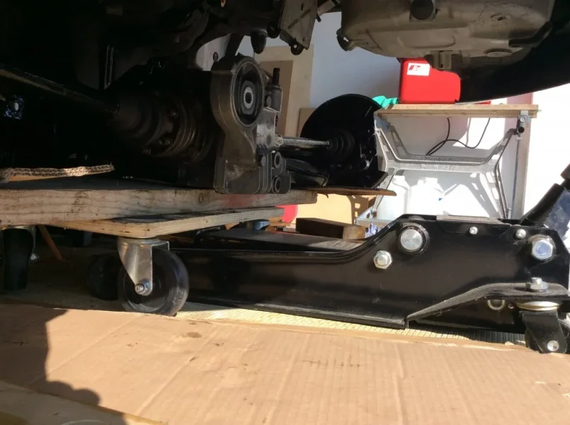

Paint dry (ish) to on to my cunning plan.....
Lifted the beam and diff using the 3 trolley jacks that I have ...then slid in a short scaffold board under the diff and on top of the wheelie board. This supported the trailing arms then put the big jack under the diff and the two smaller one under the beam each side and bit by bit, lifted the whole lot.
Had to use some blocks of wood as the two smaller jacks got to their limit but not a major issue .
Hardest part was getting the propshaft back in the front of the diff.....what a friggin’ pain !!!!!
Both me and the trolley jack were up and down like bloody yoyos’.......but eventually got it to line up and then lifted it up into position. :thumbsup: A major success....celebrated with a cup of tea!!!!
Then just a case of putting on the side plates with new bolts to replace the ‘screw of doom’ and new beam nuts, and the diff bolt.
Diff bolt torqued but the two big beam nuts are tight but not torqued yet ( I have kept a list of all the nuts and bolts that I will need to go back and torque later.)
Also got the 4 propshaft nuts on, but cant tighten them until I have the handbrake working as no way of holding it to stop it turning. ( It haz gone on ze list!!!)
And hey presto....released the jack down a bit and it stayed there :)
I then removed all the side jacks, axle stands and tools and had a tidy up.
The rear jack, I have left as it is in the picture above, as its just supporting the trailing arms so they are not just hanging off the beam
