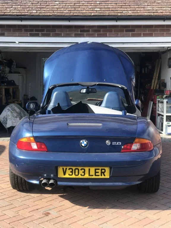

Another sunny day down in Bognor so decided to at least do something today…
Battery was a bit flat so put it on charge for an hour , and it started first time … lovely sound and no nasty noises :)
So drove the car out of the garage and turned it round …. furthest it’s gone for about 4 years =))=)),
The dash looked like a christmas tree with nearly every light on … so out with my reader and after a bit of time found how to clear all the codes …. Where’s Paul Gunter when you need him:whistle:
When the car was restarted …. this was the result…
All the Engine Management ones have cleared and only the handbrake and the three lights to do with the ABS we’re on . Which I expected as seats are not bolted down or plugged in.
So all looking positive :thumbsup:
Put the car back in the garage and put the charger back on
the orange ball stops me hitting the garage wall =))=))
This way round gives me more light and space to sort the roof.

I have a set of the Z3 boot badges if you want them? I took my old bootlid to the tip the other day and thought it was worth rescuing the badges first!
Mazza
Nov 1, 2017
175
Bognor Regis
Hi John… thank you for the offer, but you got me thinking ….
I have a spare boot lid from the donor car that has them on..
so I could swap the boot lids … but I would then have to swap over the 2.8 badges :arghh::eek:
Then remembered I had a pair stuck on my spare parts box in the garage….:whistle:
just need to find something to stick them on the car with. ( and I can make a template to get them positioned correctly )
John_B
Jun 2, 2023
114
Derbyshire, UK
Z3 2.8 pre-facelift (Izzy)
Neither my original nor replacement boot lids had the engine size on. Nor my 1.9 actually. All pre-facelifts.
Did the engine size badges only start appearing on facelift cars? 🤔
Mazza
Nov 1, 2017
175
Bognor Regis
[/QUOTE]
I have no idea =)) but could be, as my 1.9 doesn’t have an engine badge and neither did the donor car
Feb 20, 2015
2.8 Roadster
My September 97 2.8 came with the badges from new.
Sep 23, 2012
222
Stafford
2.2 & 3.0 Sport
My 2002, 2.2 was debadged from the factory.:rolleyes:
Removing badges from panels is best done with Carp braid, it's multi filament, whereas mono filament line will break easily when it heats up cutting through the adhesive tape. That doesn't happen with braid.
