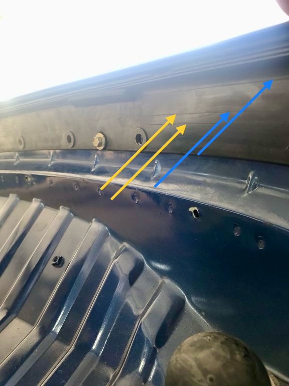

On your second picture you will see 2 faint lines above the holes, that's where the butyl goes.
Hi Eddie
I seem To have three lines on mine….so is it between the yellow lines or the blue lines???? :whistle:

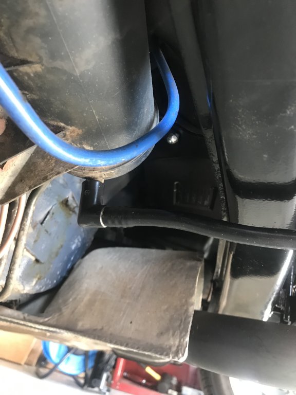

Actually did a job on the car today …nothing much but it’s been bugging me every time I go in the garage….
fitted this …
It came off the donor car I had as the one on the 2.8 has the top vent piece missing ( snapped off )
Plus it gave me an excuse to use my nugga gun 😋😋😋😋
So jacked up , wheel off and just pulled the pipe off.
that’s all the difference us… the top bit:whistle:

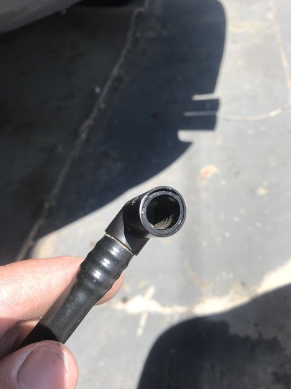

One thing I did learn was that there is a sleeve in the pipe where it fits on to the canister..
So as there wasn’t one in the new part I recycled the old one… put it in upside down just to get a better fit.
Once pushed on to the canister

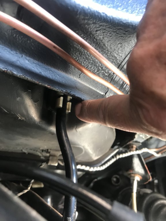

then it clips to the fuel tank
and that was all I did …
