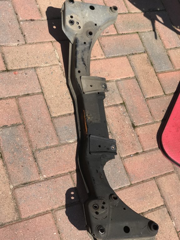

is that front subframe up for sale ? :D
Mazza
Nov 1, 2017
175
Bognor Regis
Yes ……..once i’ve cleaned it. =))

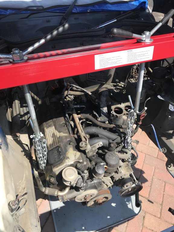

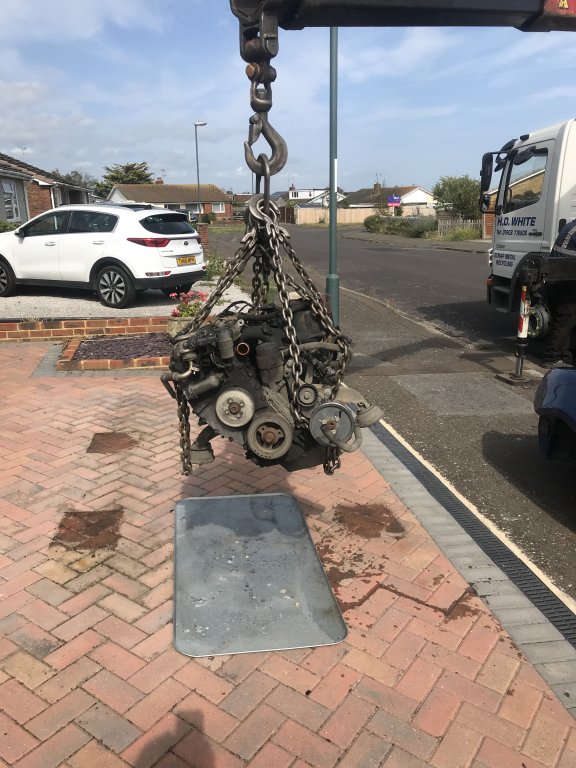

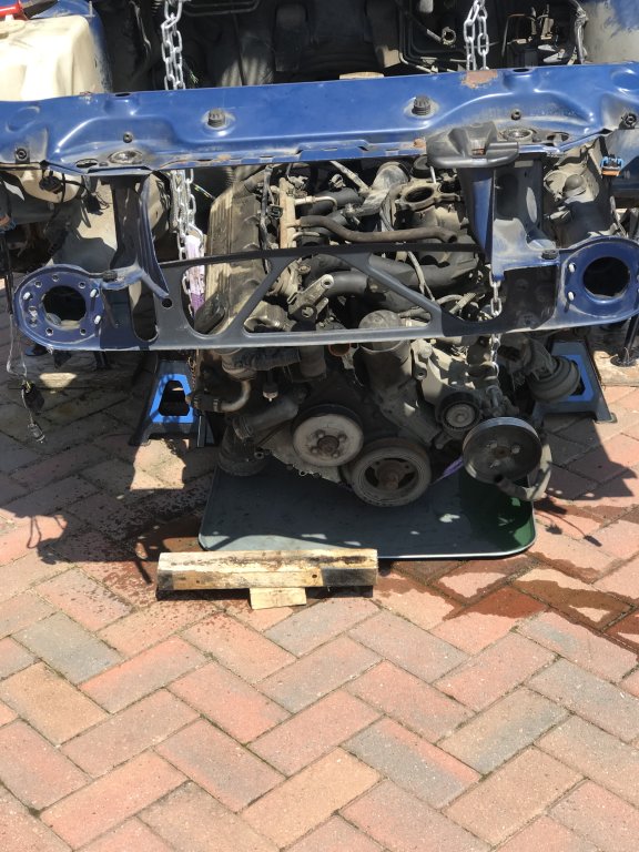

Yesterday was about lowering the engine out of the donor car … The only company that will come and take it away specifies no fluids in the car and engine and gearbox out … but will take it away …. and all for free so had to work out a way to drop the engine in a controlled manor =))
@Lee did offer his engine hoist but I had a cunning plan …..:whistle::whistle:

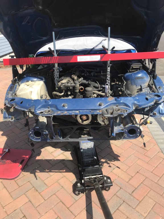

it started with putting the engine support beam in place and getting a couple of extra shackles…
First thing was to support the engine and remove the support beam…
which decided to hang on to the engine mount … so hit it with a piece of wood and it fell off…. not going underneath at this stage !!!:eek:
really good condition and now for sale =))=))
Now on to dropping the lump!!

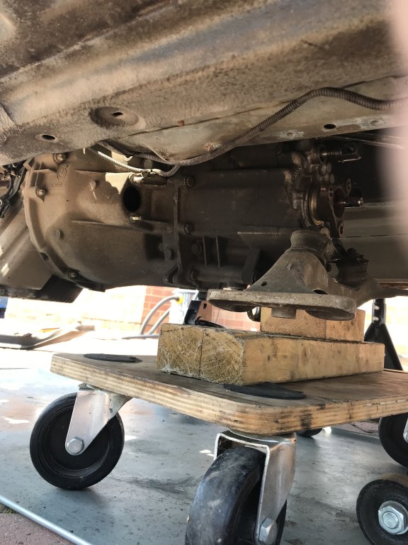

The only problem is that the screw thread on the supports were shorter than the distance I had to drop it …. but cunning plan would sort overcome that.

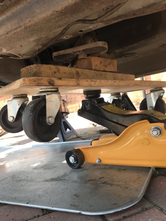

got a trolley jack and some wood etc and supported the gearbox…
bit heath robinson but it worked…
and undid the 4 bolts
lowered it down about half way and then began to do about five turns on each screw and it did start to drop … so all good, cunning plan working
then back underneath to lower the gearbox end
lowered it down to remove the jack… the tray is so I don’t damage the drive block work.

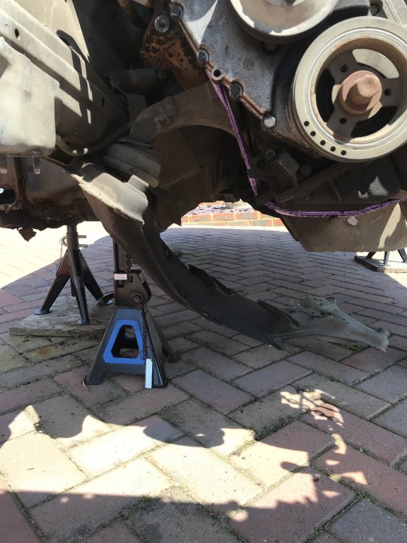

So back to the front….to continue lowering
Now came the awkward bit … I had to use a jack to support the engine, lengthen the chain and rewind the threaded bolts….. but it was at this stage I noticed some wiring was being stretched… so just cut it … easy option!!!

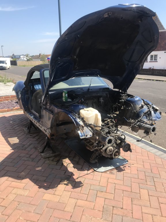

Continued to drop it until it was sitting on the floor …. then remove the wood from the gearbox and straightened it up on the tray and engine out and it didn’t fall on me … so a good result.

Is that a Carlsberg in the engine bay?

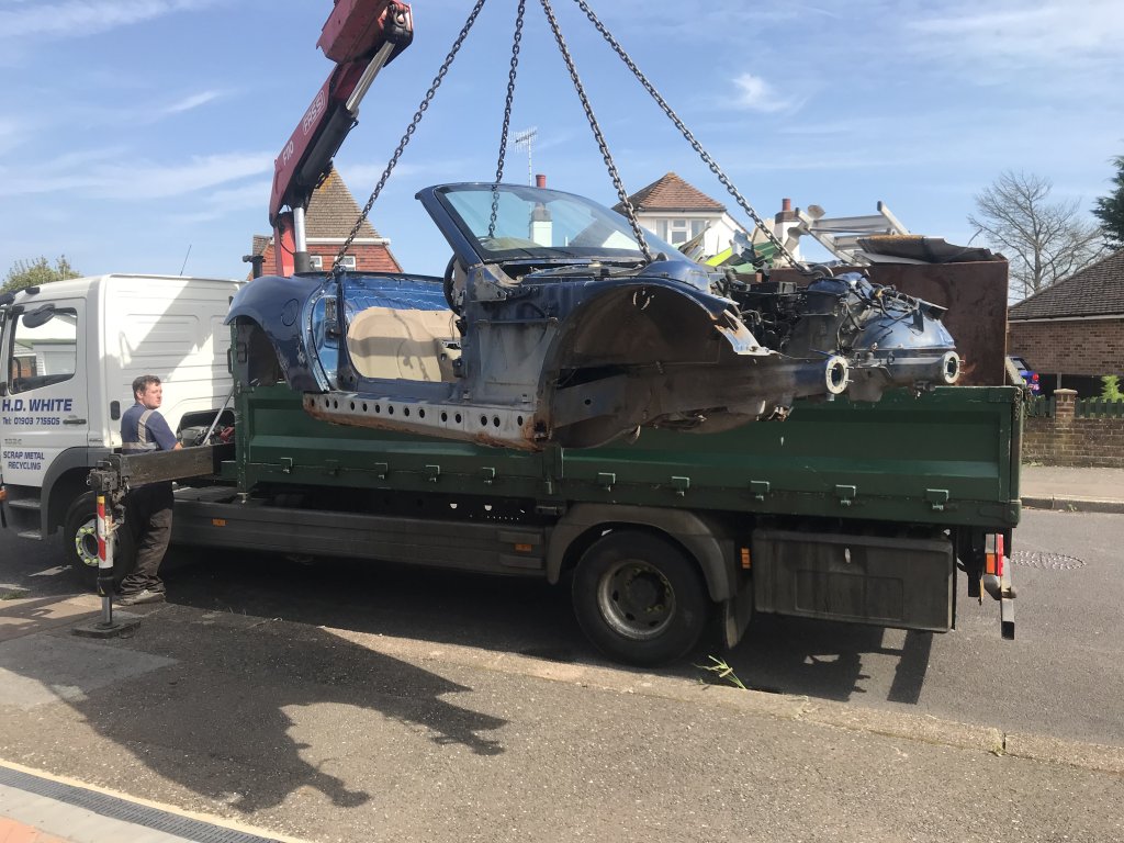

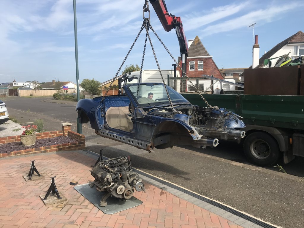

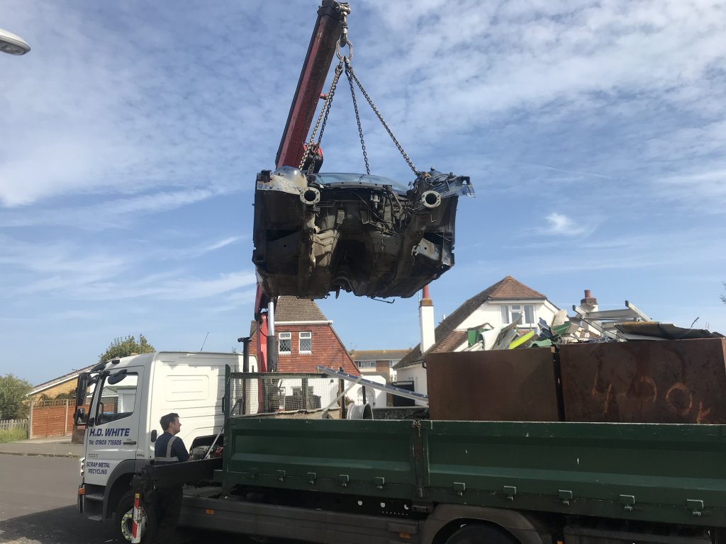

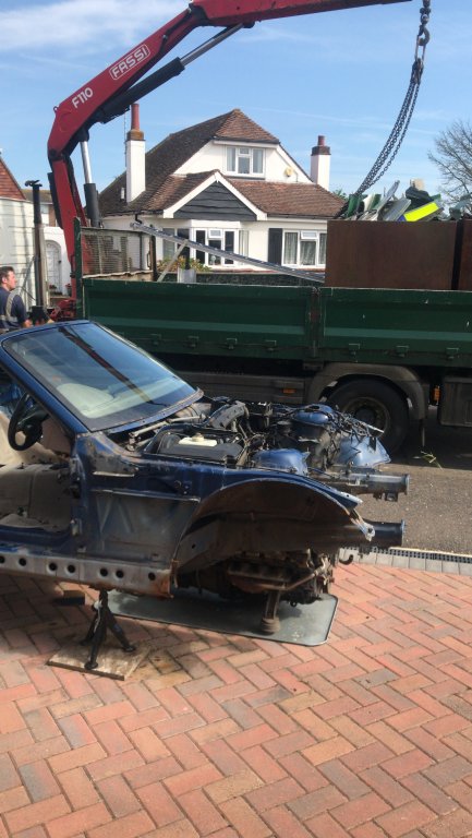

Well the donor car has finally been stripped !!
Bonnet and roof removed this morning … plus a few other parts.
Will hopefully be picked up tomorrow and taken away ….
but I did find this under the carpet….
Loads of rust and a hole in the floor !!!:eek:
Still this little car has kept a lot of other cars running by supplying lots of its parts .
In future I will leave the car breaking to Andy … this was just a one off =))=))=))=))
