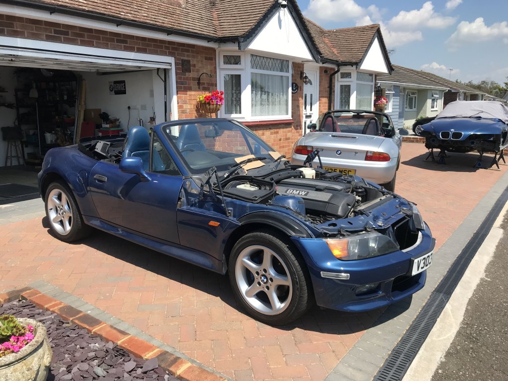

Finally it’s sitting in the sunshine on its 17” wheels
and adjusted the handbrake at the same time …it helps if it doesn’t roll out into the road :whistle:
just the roof and bonnet to swap over and it will be getting close to getting back on the road.
KASPar
Aug 22, 2023
84
Hampshire, near Z Shed HQ
Z3 2.8 M52 1998
Think you were a bit slow getting to post the image, someones nicked the wheels off the blue one in the background o_O :whistle: :thumbsup: :thumbsup:

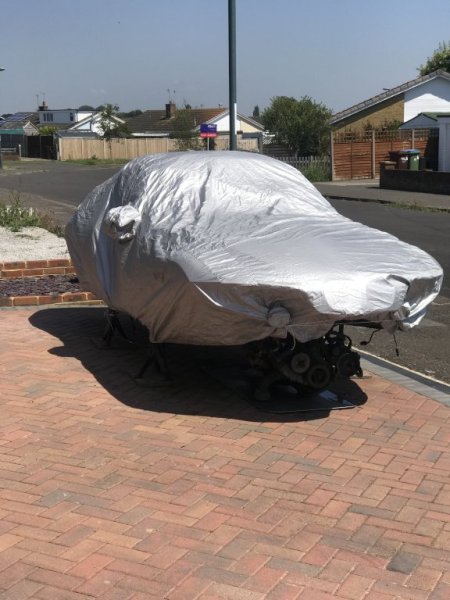

Yesterday was about lowering the engine out of the donor car … The only company that will come and take it away specifies no fluids in the car and engine and gearbox out … but will take it away …. and all for free so had to work out a way to drop the engine in a controlled manor =))
@Lee did offer his engine hoist but I had a cunning plan …..:whistle::whistle:
it started with putting the engine support beam in place and getting a couple of extra shackles…
First thing was to support the engine and remove the support beam…
which decided to hang on to the engine mount … so hit it with a piece of wood and it fell off…. not going underneath at this stage !!!:eek:
really good condition and now for sale =))=))
Now on to dropping the lump!!
The only problem is that the screw thread on the supports were shorter than the distance I had to drop it …. but cunning plan would sort overcome that.
got a trolley jack and some wood etc and supported the gearbox…
bit heath robinson but it worked…
and undid the 4 bolts
lowered it down about half way and then began to do about five turns on each screw and it did start to drop … so all good, cunning plan working
then back underneath to lower the gearbox end
lowered it down to remove the jack… the tray is so I don’t damage the drive block work.
So back to the front….to continue lowering
Now came the awkward bit … I had to use a jack to support the engine, lengthen the chain and rewind the threaded bolts….. but it was at this stage I noticed some wiring was being stretched… so just cut it … easy option!!!
Continued to drop it until it was sitting on the floor …. then remove the wood from the gearbox and straightened it up on the tray and engine out and it didn’t fall on me … so a good result.
so today was about stripping the boot lid and doors , ( already sold ) just to leave the roof and bonnet which are the bits I need.
Didn’t take too long…to have boot and doors off…
then after a bit of spot weld drilling … slam plate was off
After that was removing engine bits that may be useful to someone .. put them on the for sale section after I have cleaned them.

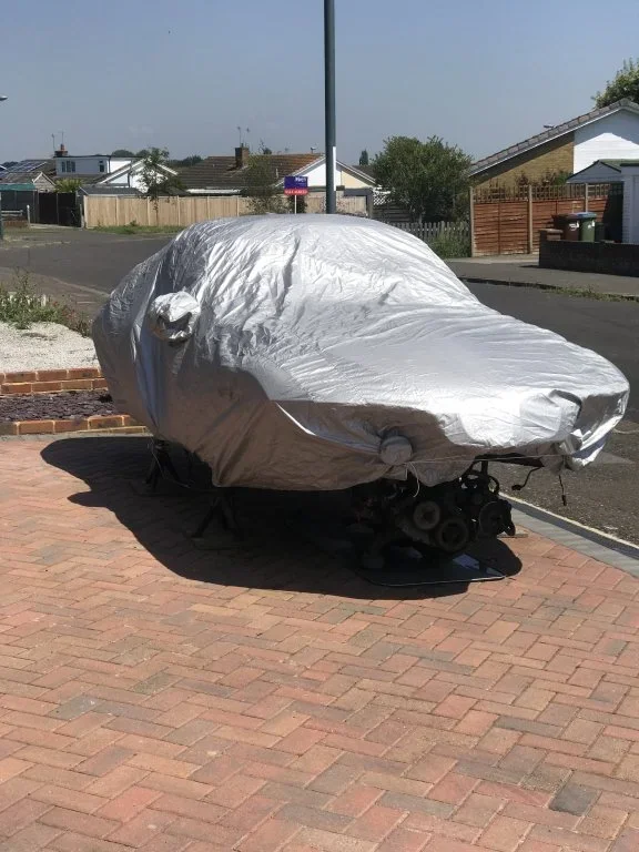

Then final thing was to put a full cover over the shell …. not such an eyesore with a cover =))
Now just need a willing helper to get the bonnet and roof off……..
At least the sun was shining as it always does in Costa del Bognor =))
