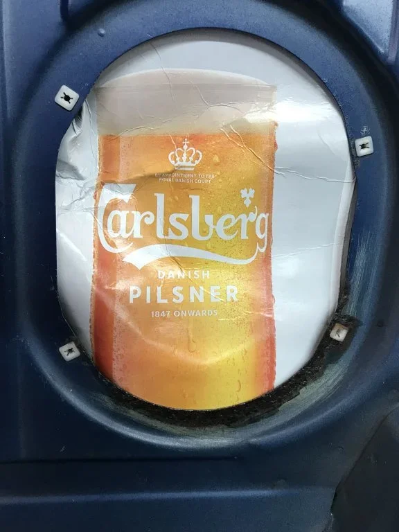

Then just a bit if tidying round the rear bulkhead at the fuel tank access.
There had been a bit if surface rust which I had treated so just blew it over….
seem to have lots of these boxes to use as masking:whistle:
If Carlsberg did car spraying….. probably better than my effort!!!=))
But ok and its under the carpet anyway
