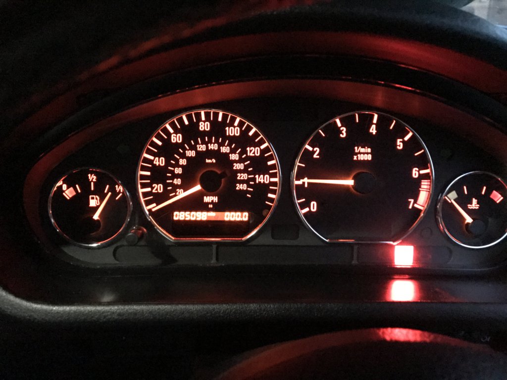

Well on with the work. When I purchased little Fi, she had a problem with the instrument binnacle such as no clear front Perspex. A quick email to Andy @spurs fan in a coupe and a big kick from @Lee to get on with it seems to have worked lol..
First up was strip out and then dissecting the binnacle to swap the internals to keep the mileage and service information etc. Then all back with the new front and fingers crossed it all went well.
Photos below tell the tale.

How fun the perspex was missing but all the same it's another job done well.
Good job done Paul, weird the front was missing. Nice easy job once you get it on the kitchen table !!:D My timing was off, it was almost teatime . . . . .
Good job there Paul, are we going to meet her on Sunday?
@mwpe All being well yes 'Fi' will be out with the pack... in the forest.
@spurs fan in a coupe Always good to see where your parts end up I would hope.
@DavidM She still has a long way to go to get to what I would call acceptable 'Forum' Standard...
Its all the fun when you get a good one to make better.
