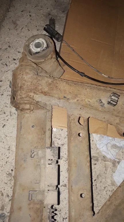

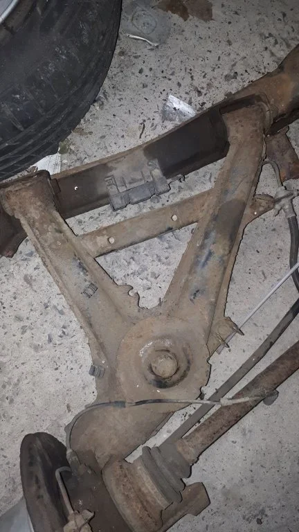

Started stripping the rear the last few nights. Got the subframe off fairly handy.
The shafts from the diff was a different issue. Hindsight would have tried the E12 bolts while insitue but sure.
Got the lend of neighbours impact wrench. Lads. Why have i been fighting with nuts and bolts by hand this whole time?! Thon thing is a dream come true.
E bolts clean off. I really struggled with the calipers bolt on the front to the point i had to give up. Physically couldnt move them. Impact on the rear. Straight off. Christmas list just got longer 😅
It genuinely makes it so much more enjoyable not fighting all night removing 4 bolts. Saying that id say id give a mean arm wrestle now lol.
In regards to the bushes now. Whats the best approach removing them? Burn all out?
