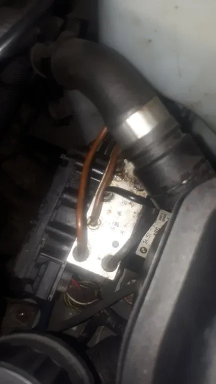

RE Break lines: Its not even corroded. the nuts are seized and damaged at the breakpipe connection. Tried a breakline spanner but wasn't enough to grip too, whoever done them prior used standard spanner and left them damaged for future persons problem (yey me!)Instead of replacing the whole line you could just replace the corroded section as it does look tricky not done myself but patience is a virtue they say whoever said it though needs crucifying.
With the exhaust can you angle grind/trimming the nuts off on the visible two? Or have room to use some heat and a impact wrench to do all three? Hope you can get them off without having to resort to fixing snapped studs. Why nuts and bolts couldn’t have been used in that are would have been easier to sort out.
