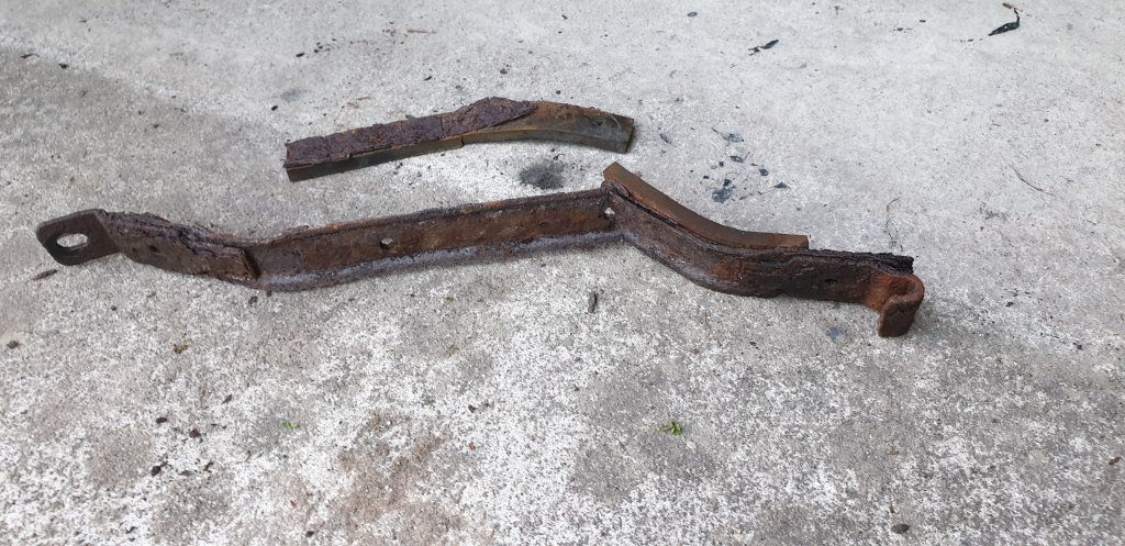

Fitted the straps supplied by Mazza this evening. An hour and a half start to finish and I am a novice!!
Passenger side was very easy. It was the most rusty so it bent really easily to come off. Driver’s side was harder as it was rusted firmly on to the chassis. I used an oscillating multi-tool to cut the strap. I put a metal wrecking bar behind the strap to stop me cutting the tank and it cut it in 30 seconds max. Very easy. See the photo.
I would thoroughly recommend Mazza’s kit and don’t be afraid of fitting it yourself. If I can do it, just about anyone can. The straps are very well made, the service from Mazza was great and it all worked just as the instructions said it would.
