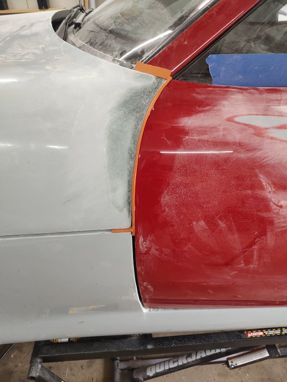

I'm happy to say the weather is getting consistently warm enough to do bodywork! The big project for today was seeing if I could correct some panel gaps.
I started with this...situation. I found some nice gasket material that was pretty close to the panel gap that I want. A buddy sent me a video of using wax sheets to do this. Pretty clever. Anyway, here we are:
The gap is weird. So I did my best to use aluminum tape to act as a backer, then filled in with fiber re-inforced filler.
Once that was in I used some body filler to smooth things out.
Not bad! Or at least good enough for me :). I do have to remember to add some reinforcement behind the filler though. I realize the fiber reinforced body filler probably won't last on its own. I'm going to call this a success and do the other side.

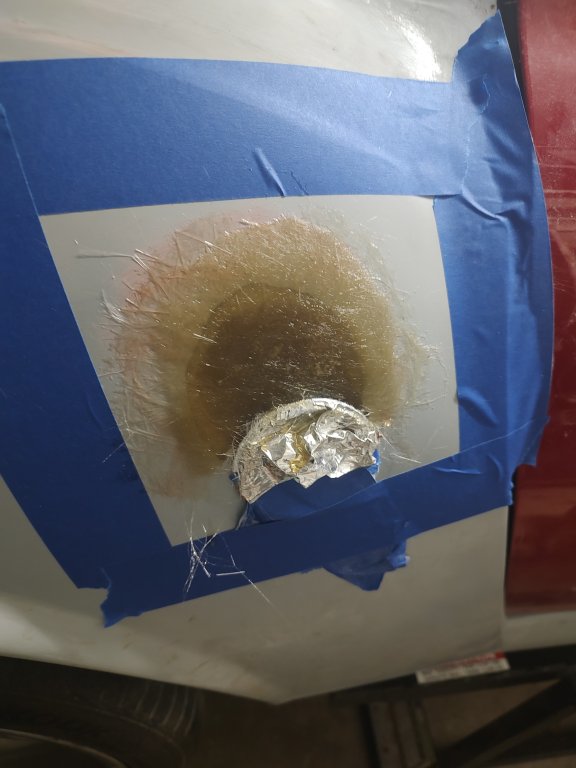

Finally fixed the rear of the car on!

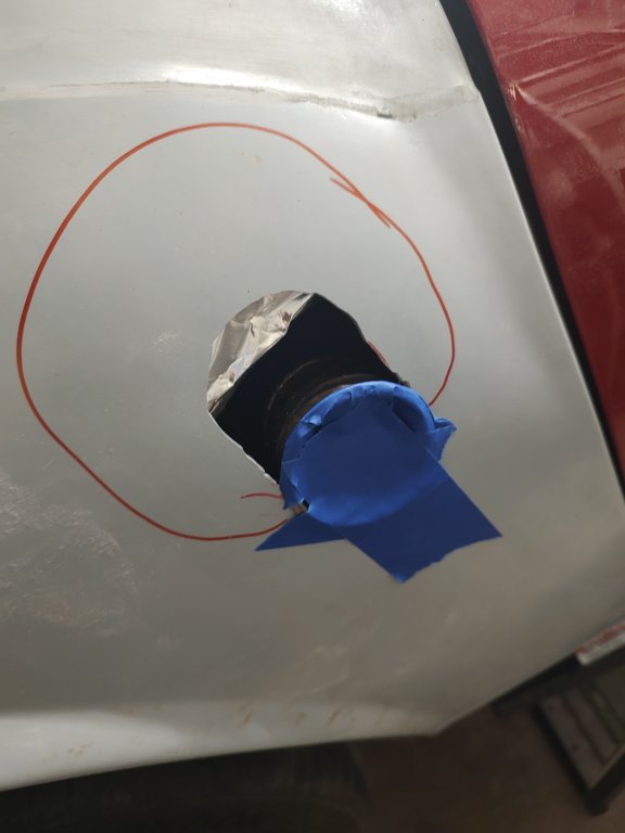

First thing was to patch the huge hole I made trying to position the fuel filler door.
I put some aluminum tape behind the hole so I had something to work against.
Then the entire rear of the car came off so I could ensure the fuel filler door was captured securely.
While that was setting up the modified gas cap was fastened back onto the car.

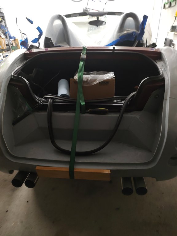

The entire rear of the car was bolted back into place. A ratchet strap was put on to try and pull the rear trunk lip closer in. I am hoping this will help make the trunk and body line up better. This is a poor description, but I'll do my best to show it in pictures in coming posts.

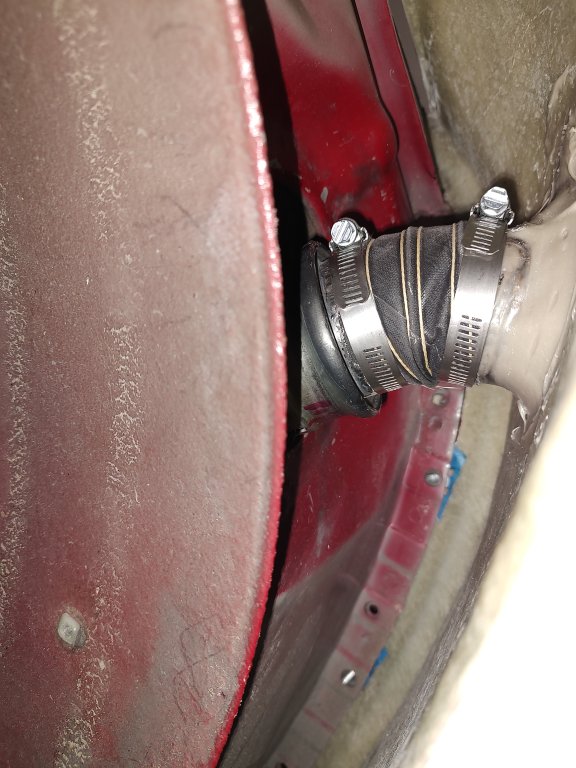

The flexible fuel hose was then put on. I added some hose clamps because it made me feel better. Also, notice how the hose clamps are oriented in a way that I can losen them in the future. Some of you may have been in a similar situation with hose clamps before...

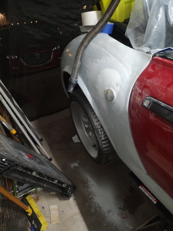

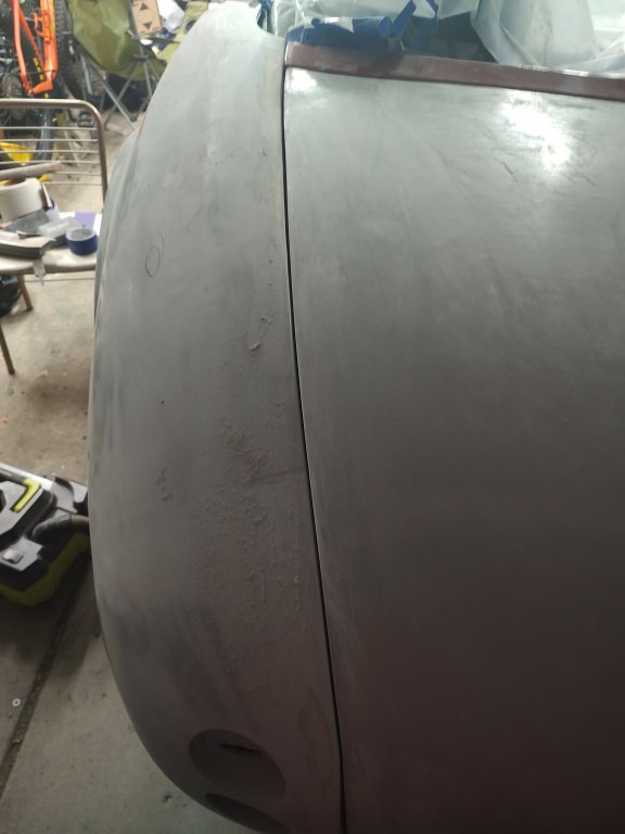

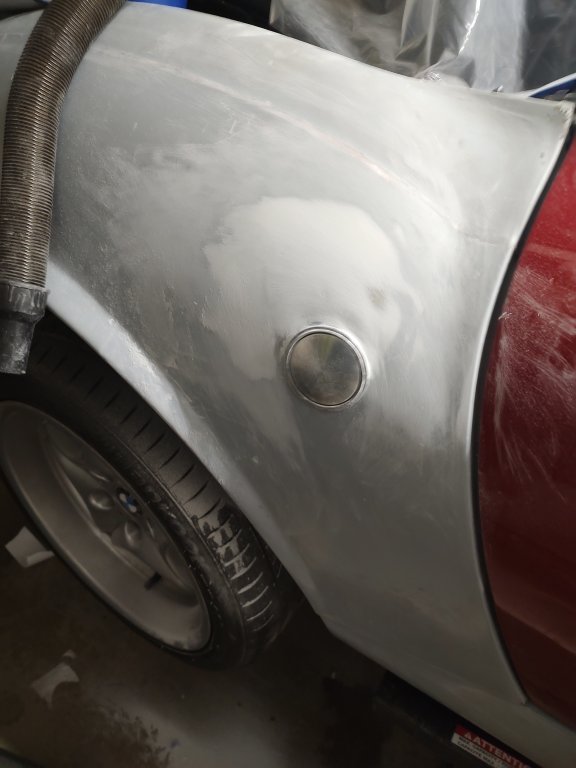

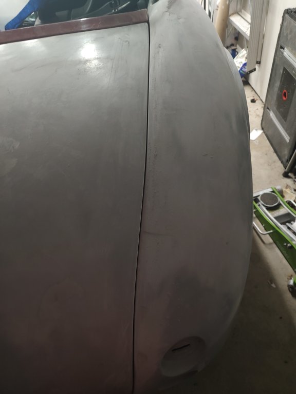

Started cleaning the body up. Sanding down all of the joining lines and making the area around the fuel filler look better.

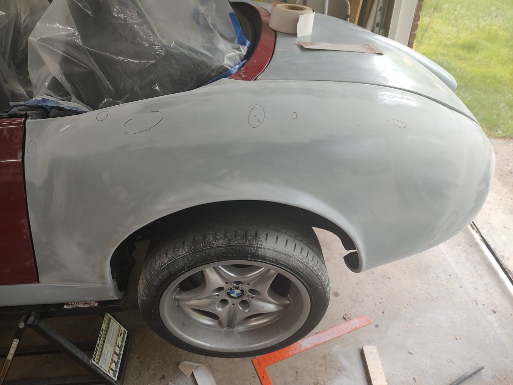

I marked some spots here that I will address later, but both rear quarters will need to be modified quite a bit. I'll get to that in a moment...
I'm happy with how the fuel door turned out. It will be nice to be able to fill the car up at a gas station without getting weird looks. (Picture someone elbow deep into their wheel well fishing for the fuel cap.)

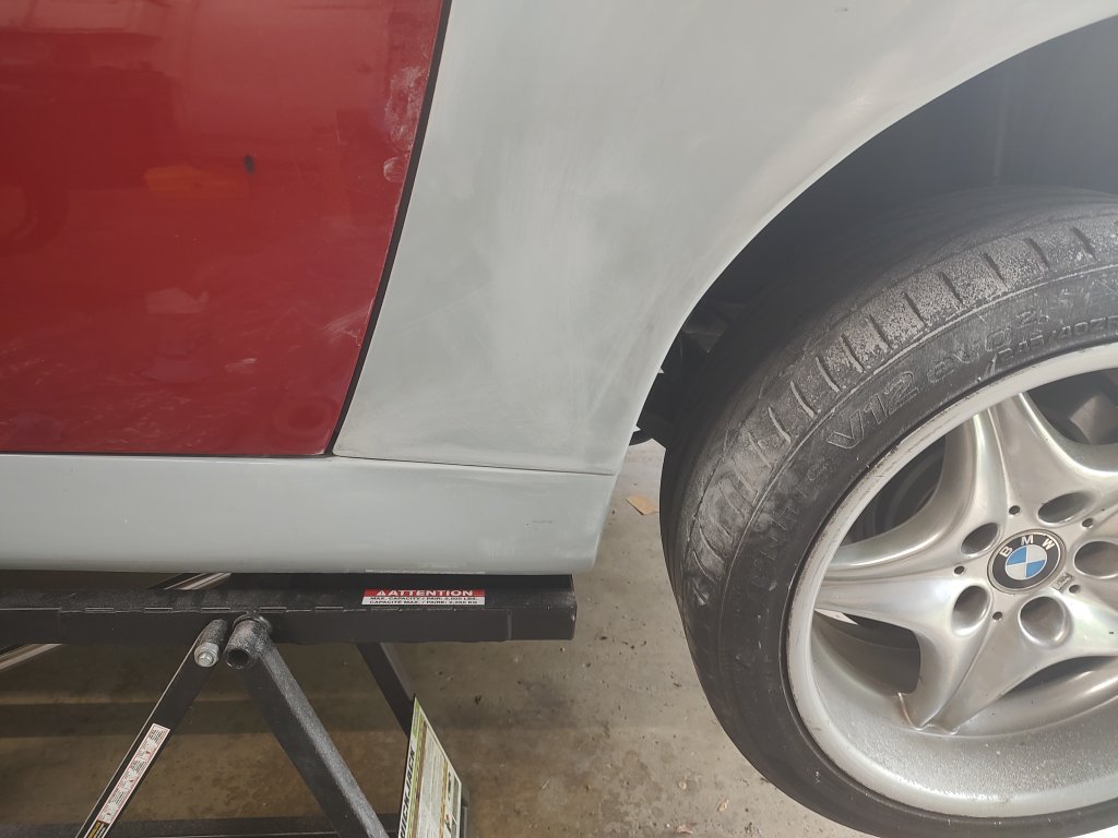

I started widening the panel gap here. I realize the car probably won't have consistent panel gaps all around, but I'll attempt to get them close enough. This area sits right on top of the sill, so I've been sliding sand paper between them to try and open it up a bit.

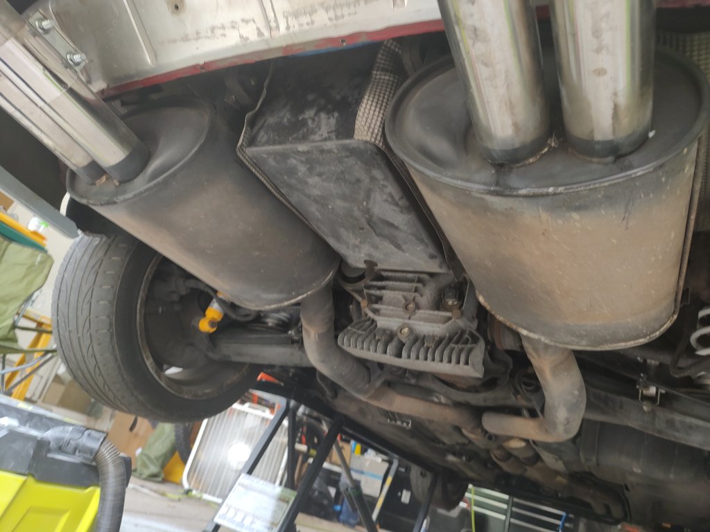

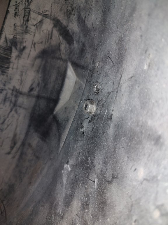

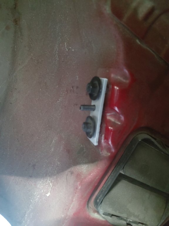

This is my solution to my wheel well liners. The original wheel liners in the rear of the car attached on the forward, top and rear. The rear bracket no longer exists for the rear so the back side of the wheel liner was just hanging. I made a small aluminum bracket and mounted a bolt to it. I think it will work pretty well :)
Ta da! Exciting isn't it?
Wheel liners installed. Looks like I have a tiny bit of trimming to do on it yet, but it's super close being done.

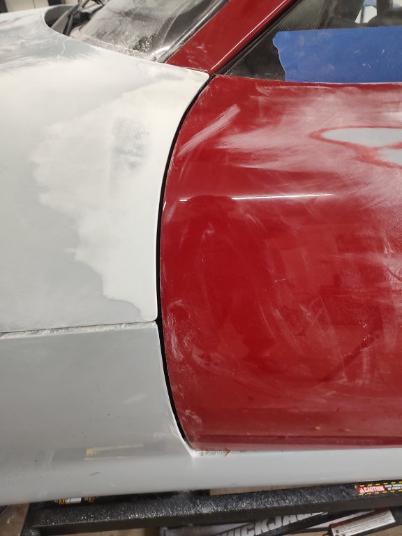

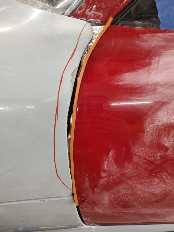

Here is a problem. The rear end is now fixed in place, but look at the panel gaps. There isn't one between the original red panel and the quarter panel. I can't just shave the quarter panel because the panel gap will look super weird as it transitions to the trunk gap. Another option is to cut the rear quarter and shift the entire panel gap which would require widening the trunk. Third option is to maybe put a small 2" rubber piece there to cover it up on both sides. Forth option is to just live with it. The other side of the car has a decent gap, so it is not symmetrical (this bothers me). I haven't decided how I'm going to do this.

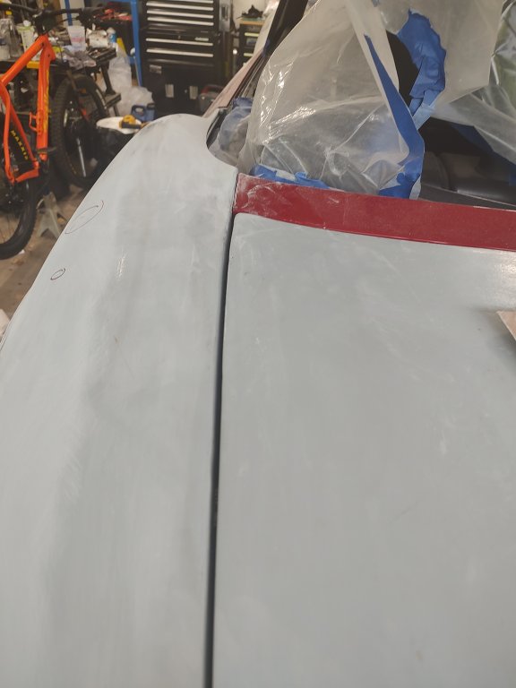

Didn't I already post this picture? Yes, but now we are looking at something else. Look at the trunk. It sits flush with the rear quarter panel up until the body curves down, then the trunk sits proud of the body. I think I'll have to build the quarter panels up to match the trunk here. The other side is very similar. I can't do any of this until I finish getting the trunk to sit right though...
I'm also debating on shaving the rear lip to make the body and trunk flush together. This would require building up the body from the back so I have enough material to shave off. It would be a lot of work and would be shaving off a LOT of material. Roughly 2-3cm!

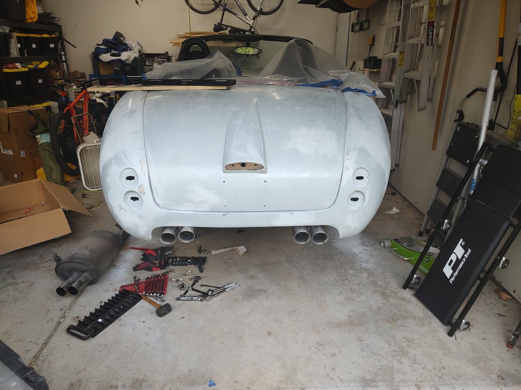

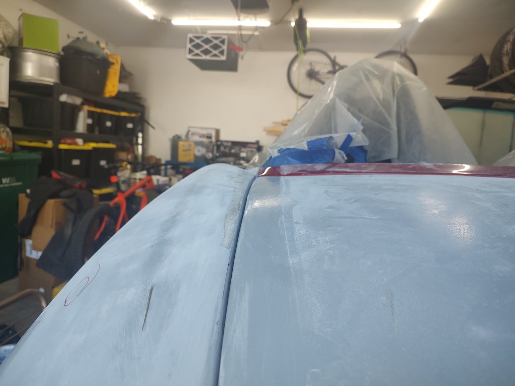

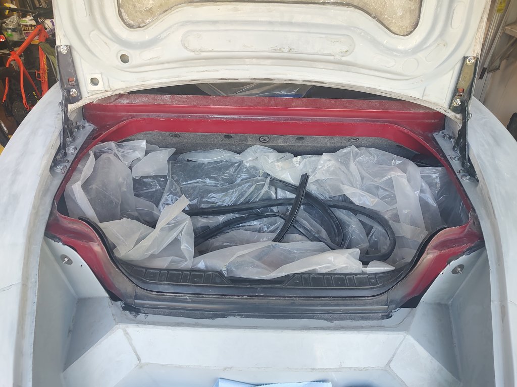

With the rear of the car on. I was able to get the trunk(boot lid) to sit in a way I like. First thing I did was mark some spots so I can take the trunk off and be able to put it back on right again. Then I sealed up areas around the opening so that water doesn't get into the ...what do we call the extended section? The hand bag holder? Maybe it'll help me organize groceries one day. Anyway, here we go:
Next step, sanding down high spots and working on panel gaps. The driver's side was sitting quite a bit higher then I would have liked, but I sanded it down and I think I got it relatively good enough ish.
The passenger side wasn't near as bad, but it still needed work.
The panels gaps are coming along, I'm very close to calling them good enough.

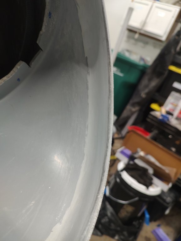

One of the last body shape questions I'm considering is dealing with the lip on the back..see here:
I'd really like it if I got the trunk flush with the bottom edge, but there are only two ways of doing that. Build up the trunk (meh) or build up the back side of the bottom edge and grinding off nearly 25mm of fiberglass. The more I think about it the more I'm thinking it's not that big of a deal. I will clean it up some and focus on fit and finish.
Now I have to figure out the trunk latch situation. My original idea was to use a classic hood pin, but upside down. The idea would be that the trunk lid would have the pin and you would unlock the trunk by reaching your hand under the lip of the body (between the exhaust pips). It occured to me that this car is very low and I am very tall. I'm re-considering my options. I can't put the standard 'T' handle under the license plate, there is no room. US license plates are taller than UK ones, so if I fitted a lock it would have to be either behind the license plate or off center. hmmm..
See? No room for a trunk latch. Unless off center somehow? Flip up license plate to reveil a latch?

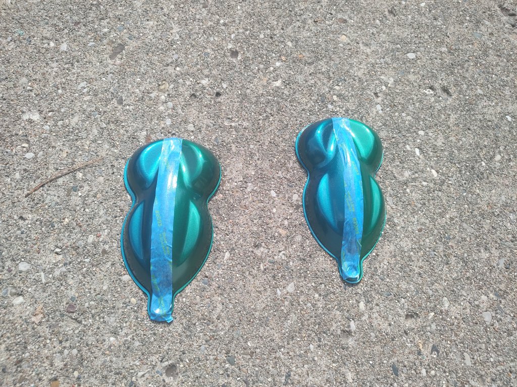

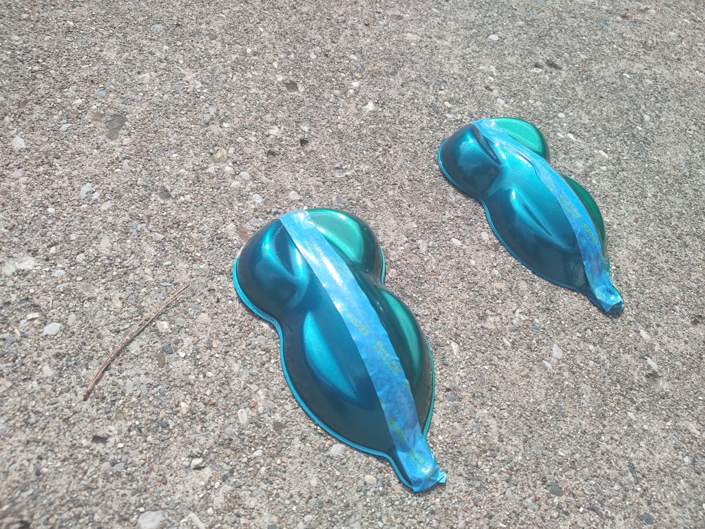

Paint samples are in! I learned that that small air compressor is not remotely big enough to handle a low volume paint gun even for small samples like these. Either way, I got paint on the samples and something to look at. One of these is a black base coat and the other is a white base coat. They have been clear coated as well. I don't think there is a wrong answer here, so I'm letting it marinate on my mind a bit.
Both are BMW colors. Atlantis Blue (399) and Isle of Man Green (C4G).
DaveP
Mar 26, 2016
128
Reading
Z3 2.2 Kobra rebody (see pic)
My vote (not that you asked) is the green over black base.
The pics confused me as I thought you were going color shift which would be a bit lairy but cool.
Dave
Argyll Andy
Jun 4, 2021
79
Argyll
Z4 - M40i
Again, not that you asked but IoM Green over black :thumbsup:
