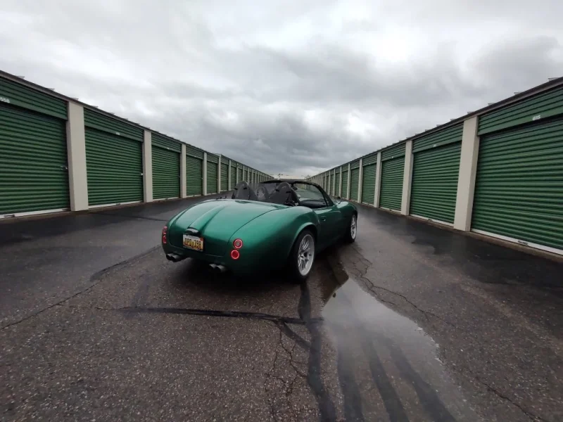

It's been a minute! I had to relocate the car and found a storage unit of all places to finish it in. Good thing everything I have is battery powered. I'm wet sanding everything by hand anyway.
So latest updates...
Car is in a new home:
I've been sanding so much. I ended up dropping to 1000grit wet sand to try and speed things up. Helped in some places and in other places I burned through, which took the paint right off. Sigh. Just keep pressing forward.
I made some additional changes to how I was wet sanding. In some ways I wish I didn't try to go for near perfect flat. Leaving some orange peel would have helped hide imperfections. Too late for that now, but I did decide to leave the orange peel almost untouched towards the bottom of the car. These areas don't stand out too much and need all the protection they can get. This car is a rock chip magnet.
