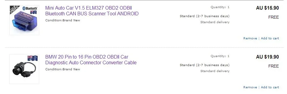

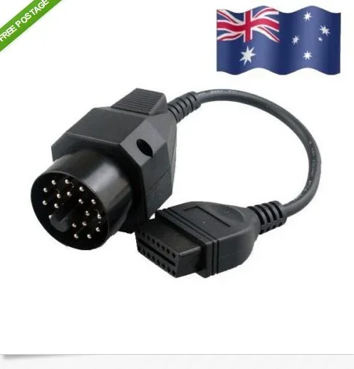

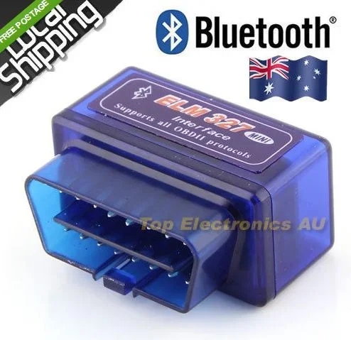

Hey guys, can you please advise if the following components will suffice for diagnostics, and clearing of codes with the appropriate software? I have included pix and the ebay reference numbers for the parts. I suppose that it would be better to purchase a good app from the app store to go with these items to have full functionality. I am starting to get somewhat confused with all the chat above and am unable to make a decision on what I should have. Thanks. I have tried to make the pix small. Seems cheap if they actually work! The magic is in the software I suppose.
01. Mini Auto Car V1.5 ELM327 OBD2 ODBII Bluetooth CAN BUS Scanner Tool ANDROID 190868683257
02. BMW 20 Pin to 16 Pin OBD2 OBDII Car Diagnostic Auto Connector Converter Cable 190990280095
Hi Cooper
The above items are ok, but the blue tooth ELM will only work with an android tablet, if you want to use an Ipad you will need a wifi ELM device. If you are using Android then you are ok.
Rich
As Rich says :)
