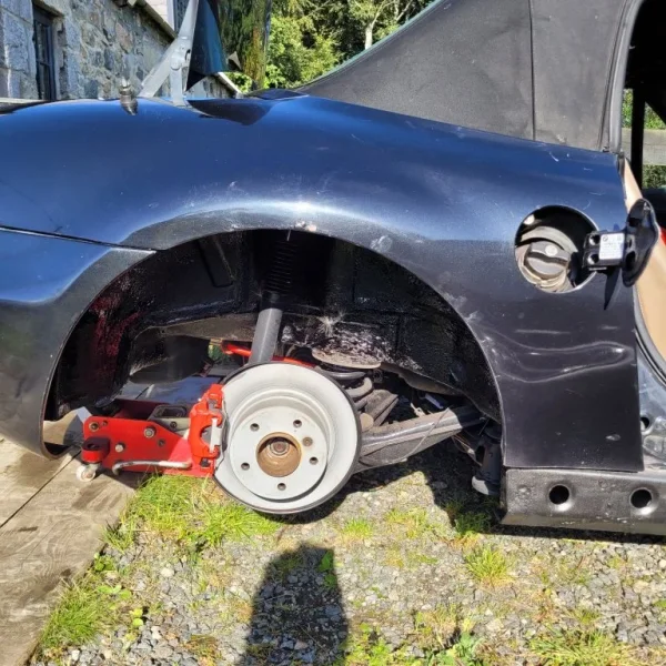

I've cut the rot out the rear jack pad point and patched it up. It still needs a bit of dressing off but at least its now solid. Undecided if I'll bother with holes to replace the pad as I just use the diff to Jack up the rear. One more bit like this to sort and then I can get back to spannering and the nice stuff to be working on.

I've had a big push the last few days and I've finished the welding. I've also dug out alot of the seam sealer and resealed it. It'll get a fresh clart of stone chip on tomorrow and I'll update with photos.

I managed to get the stonechip sprayed today. I also refitted the cross brace and centered the steering wheel. I could get the steering center before but the rod ends weren't really centre. I must have cocked up putting the rack back in. So I put the wheel on a quarter off and adjusted the rod ends. Eye ball looks like the wheels are pointing the correct way but they'll need alignment. I think that's the majority of the stuff done that I need to lay under the car for, so it's out the shed. It's starting to take shape think..
I need a new radiator and pws cooler pipes but they're on the list until next time.
Sealed and stone chip coated
I've still to replace the outer sill cover and wing on the drivers side.

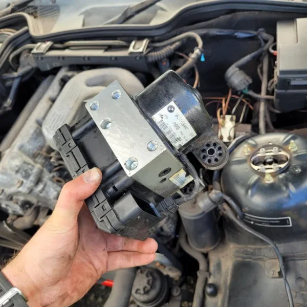

I am having a bit of a push again. I've got a new/ used abs pump in bound and a new radiator. The alternator on this engine is dead as well. I really need to get the other one back to the house.

I've had a quarter panel in the shed for replacing the picky one. The new one needed a little rust treatment as well but really not bad.
Once I got the panel off, I came across an aftermarket hole, so i zipped it up.
And a coat of paint

The wobble is fixed and the interior is in. I've still to dye it but it'll do for the MOT. The car is looking pretty funny just now with its mutli colour appearence.
I've recieved and fitted the abs pump thanks to @Andyboy for the speedy delivery. I've still to bleed the brakes but first up is trying to code the module to the car.
