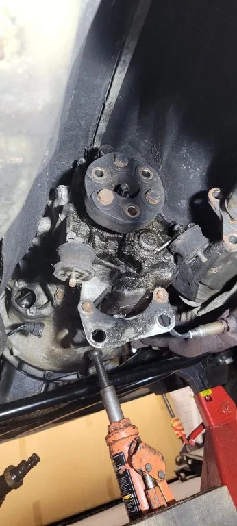

After the the hose bursting the car wouldnt run smoothly and due to this the emissions couldnt be tested. It took me 10 months to get the car back due to not prioritising it. Once I got the car back I did a little digging and found one of the vacuum pipes was disconnected. It also presented codes for the cam sensor and the O2 heater. I replaced both of these and it was back to running smoothly. I stuck it back in for a test and she failed again due to a new PWS leak and rear brake efficiency. The steering rack had slight play in it also.

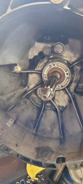

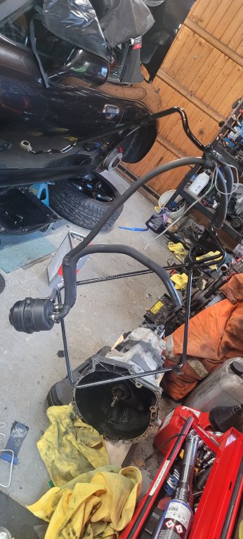

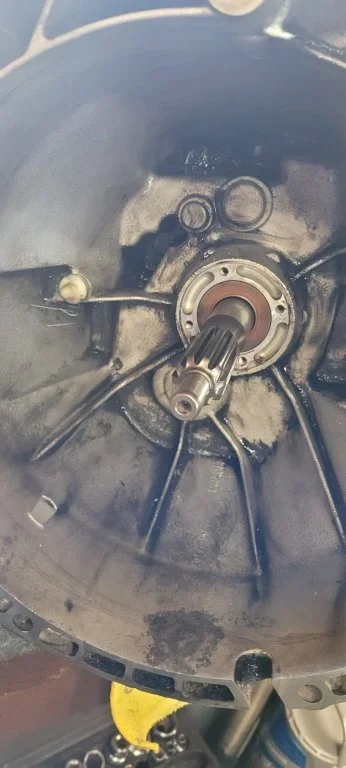

I bleed the brakes again and it looked to be good, went to move the car and the clutch slave had failed. Replaced the slave, bled the clutch and then the new slave failed but launching the rod into the bell House.. super... gearbox out time.
The fork had some wear and the pin was also worn. I was at this time thinking about sourcing a newer box as the box looked a bit leaky, but I opted for new seals and fork bits. I replaced the clutch whilst I was in there.

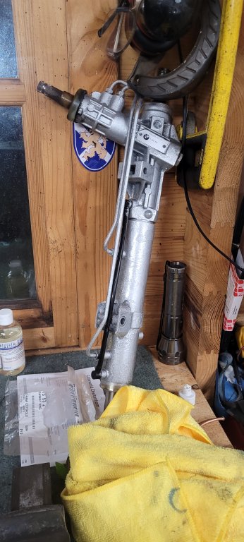

I sourced some replacment pipes and oil cooler from ebay and a replacment rack from Quarry motors, supposedly from a 30k miles car but it has cured the play.

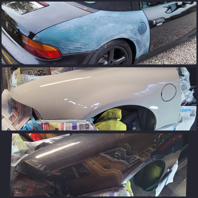

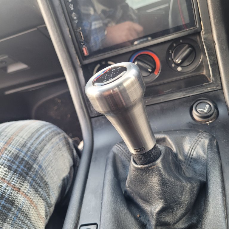

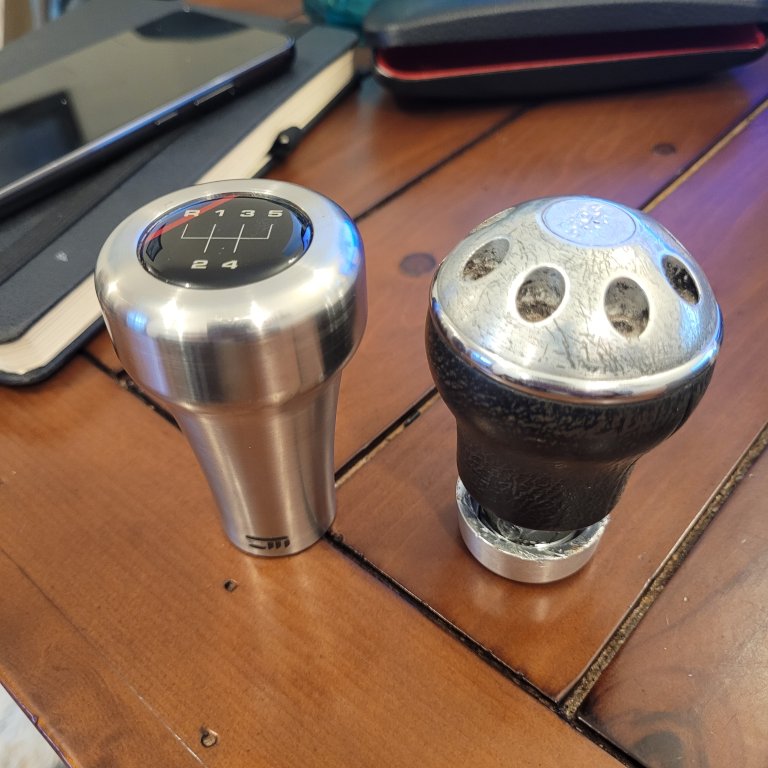

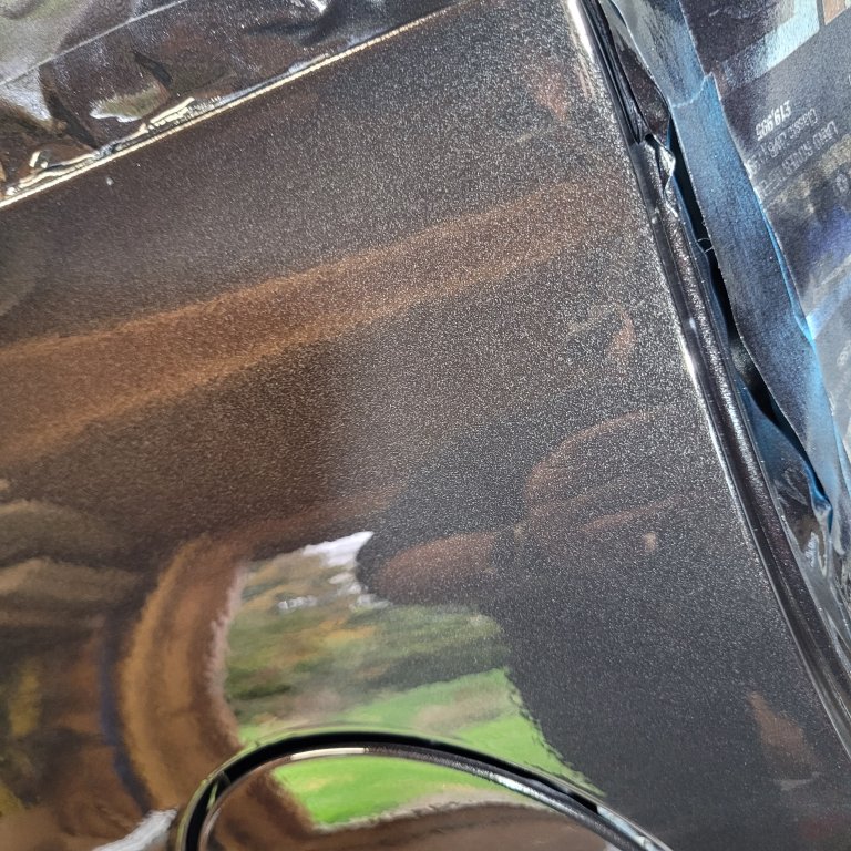

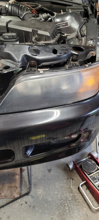

Some nice work there, bet you were glad to get rid of that Ripspeed special. Did you rattle can the wing?
Yes the knob was very ugly, the new one was an ebay bargain but feels quality. Yes, it was a rattle can job. I keep threatening to order a compressor but it would just be something else to store.
