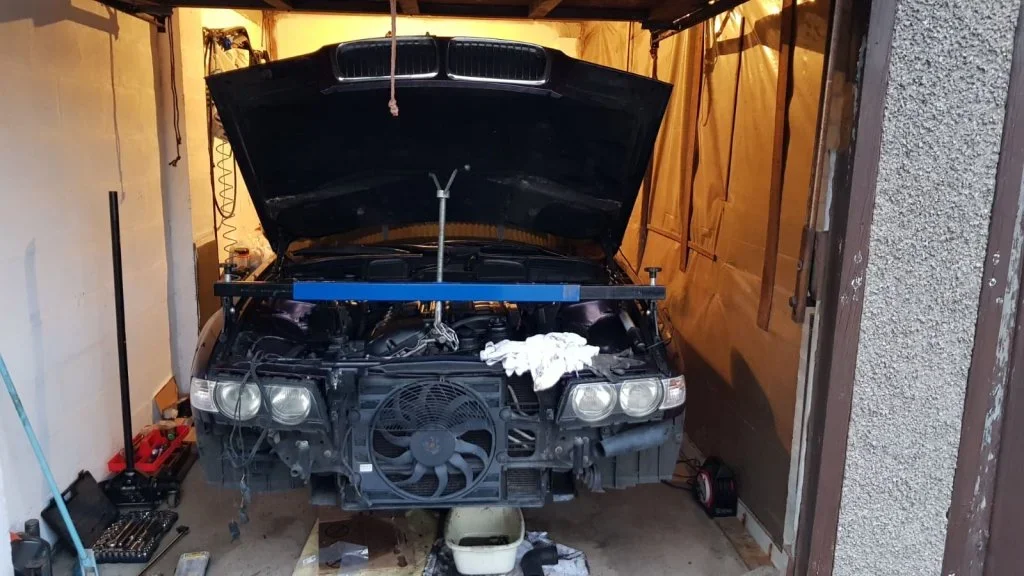

The borrowed engine brace is in place. Amazingly I had to make it wider and the last car it was used on was a 7 series. I've got one side stripped and ready to drop. Quick coffee and I'll get the other side done. Surprisingly enough everything so far has come apart without a fight, not bad considering how rusty everything looks. I should get the bits off for powdercoat today along with the wheels. I am looking forward to having the suspension done so I can turn to the engine. I still don't really know the condition of it yet.

That's the other side out and the subframe and brace ready for powdercoat. I've 2 shear bolts on the drivers hub to deal with. The cars radiator has definatly seen better days. Next up.. tidy the shed !
