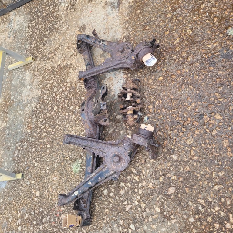

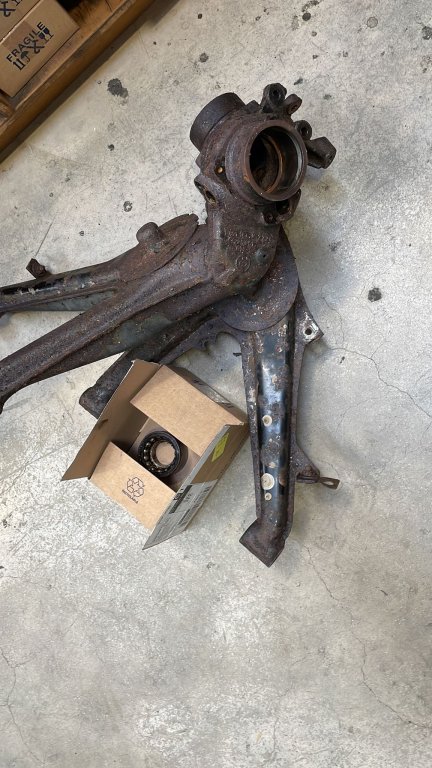

That's the rear bearings out. I'll get all the rear gubbins away for a blast and powder coat tomorrow. Trying to resist making everything red to match the seats. For me and the mot testers benefit

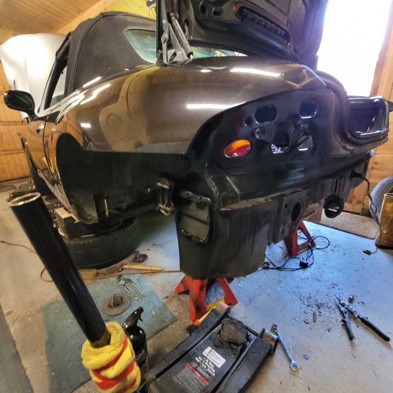

The chunk of iron is off the back. I've probably just reduced the cars weight by 25 -30kgs. There is some aftermarket holes in the car I'll need to seal up somehow.
Here are a few pics of how the tow bar was installed. Pretty sure this isn't a bmw part
colb
Nov 25, 2012
178
Newport, South Wales,UK
Looks like the fixing points were minimal, probably just about good enough for a small camping trailer, jet ski or small Dingy would be my guess. Looks custom made since the car didn't have towing authorised by the manufacturer.

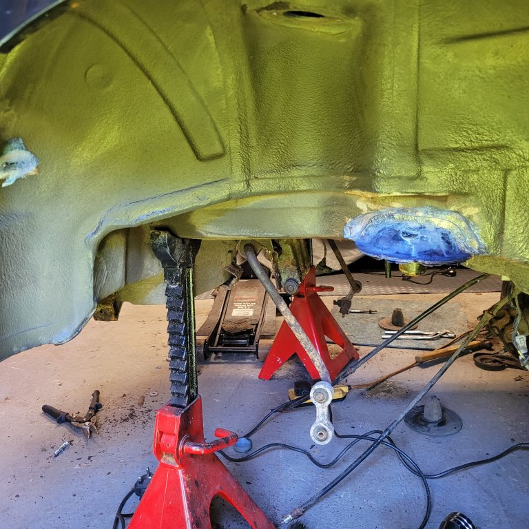

So the gubbins are away for a blast and powdercoat. I've played it safe with gloss black and red calipers. They should be back next week. In the mean time I am cleaning up and treating any bits of rust I come across. I've still a stripped nut on the arb to tackle.
The stone chip bmw have used has done a great job of keeping the car clean. It had delaminated about the shock mount, so I've cut it back to shiny metal, wire brushed and treated..

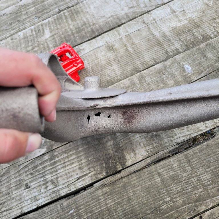

I've also been to the sand blasters. The offside trailing arm unfortunately has seen better days but everything else is nice.
Not 100% sure if I can have it welded up or if I'll just source a better 1.

Problem with welding up things like that is that you end up chasing steel. What I mean by that is that you fabricate a new piece of metal ready to weld in but the torch just blows a hole in the old steel and you have to make a bigger piece.
I'm also not sure about the rules whether you'r allowed to weld those parts. Personally I would never weld sub frame or suspension parts.

I am going to try and source a fresher 1 to be honest. It can be welded if it's done correctly but it's beyond my bag of tools which would mean outsourcing. Cheaper in the long run to find another arm. Looking at ebay circ £150

Looks like it would need a fair sized patch to be let in to replace that corrosion area, doable by a competent welder but probably best to find a better one, I understand they are injected with oil when the car was built to resist corrosion might be an idea to inject spray some clear waxoyle into your fresh arms and then plug the hole with a plastic plug for future top ups
