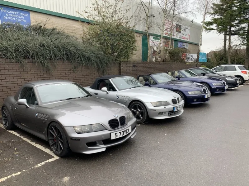

Great day down at ZedShed HQ with @Lee @GazHyde @Oldguysrule (Trev) @pgunter @Grumps and @Mazza
First thing was to find Blue under the mess and dirt!
