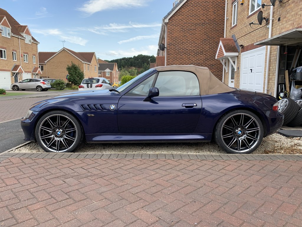

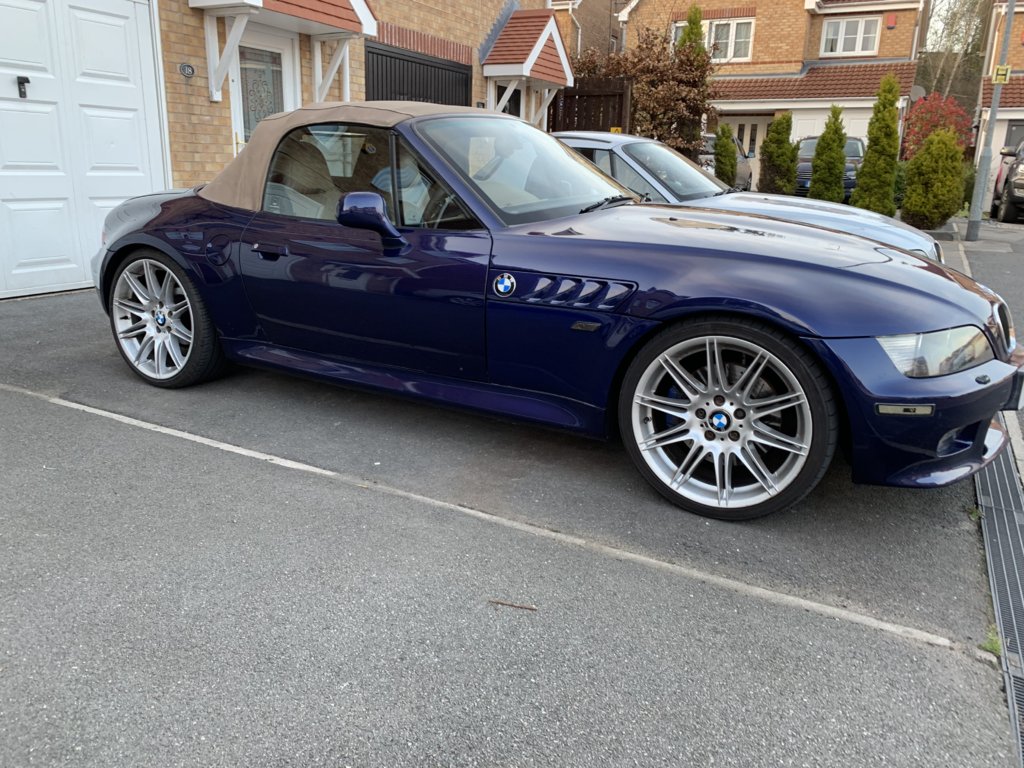

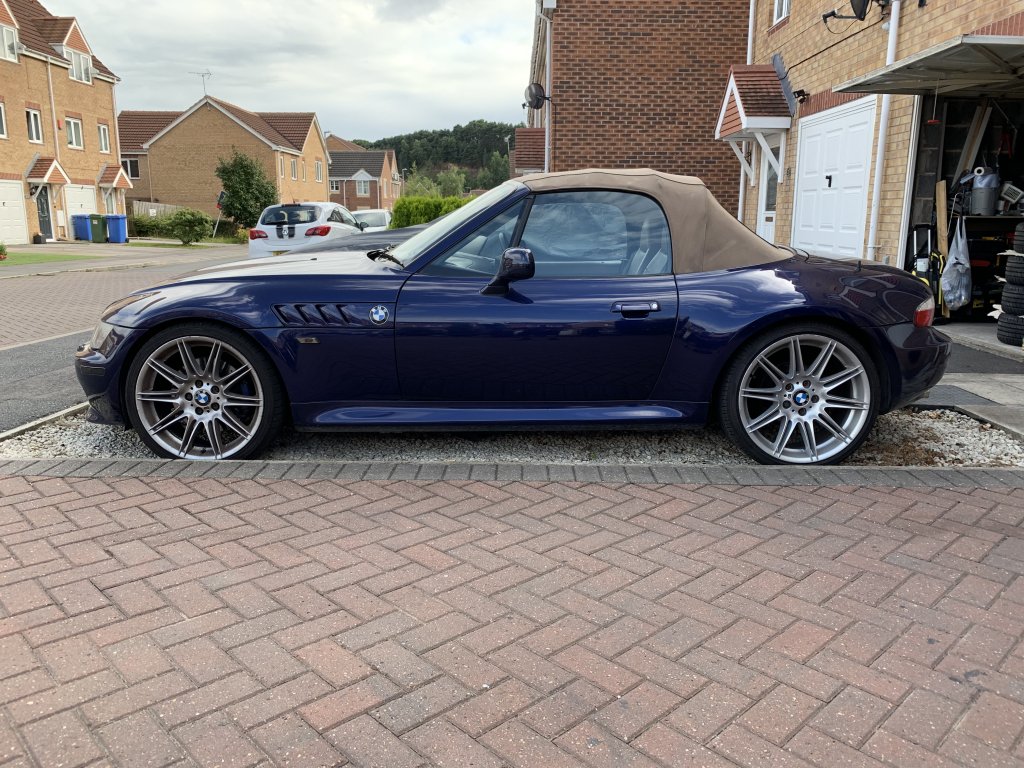

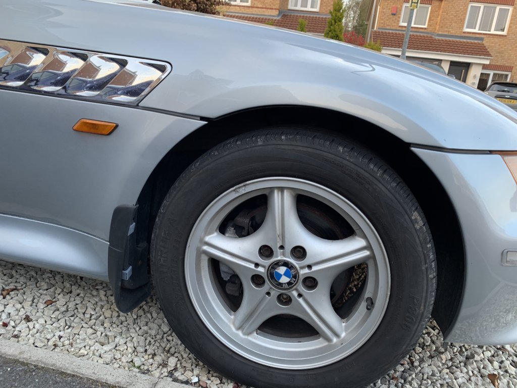

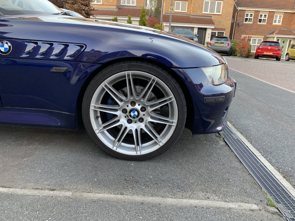

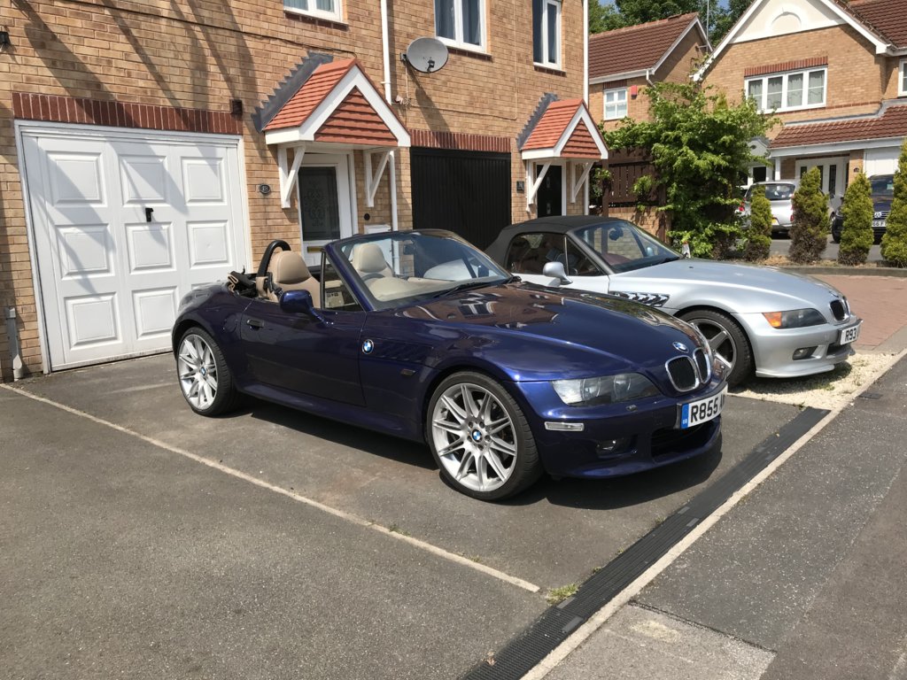

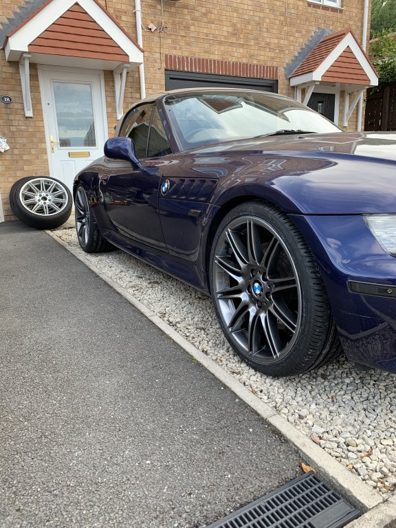

Thanks to ZedShed Midland the Blue had new suspension all round (Monroe shocks and Eibach Pro Kit springs), diff oil change and gearbox oil change.
Oringinal suspension:
With new suspension:
View attachment 98655 View attachment 98654 View attachment 98656

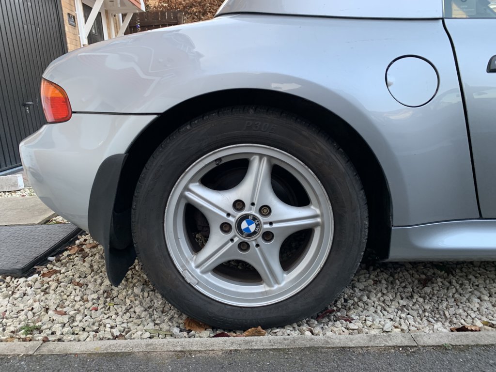

Compared to standard suspension and wheels on my other 2.8 Silver:
View attachment 98658 View attachment 98657
Looking great pal, Monroe shocks are such good value for money and as we all know Eibachs are cracking spring and who would have thought that 30mm could make such a huge difference

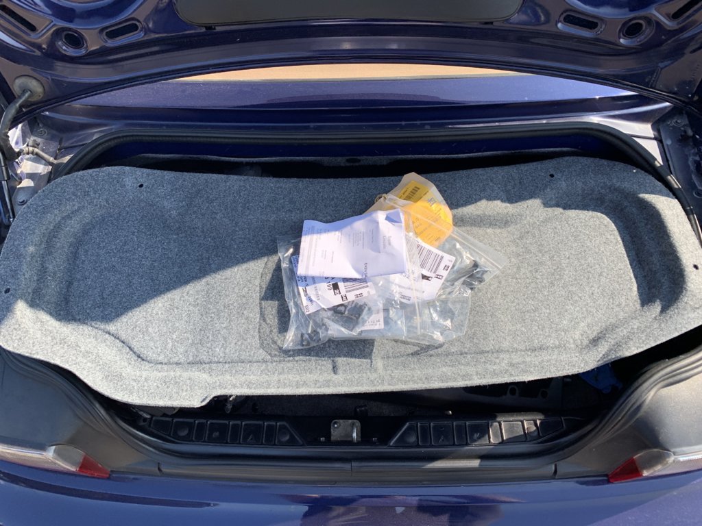

Where did you get the trim from pal
I had to get it from BMW directly :nailbiting:

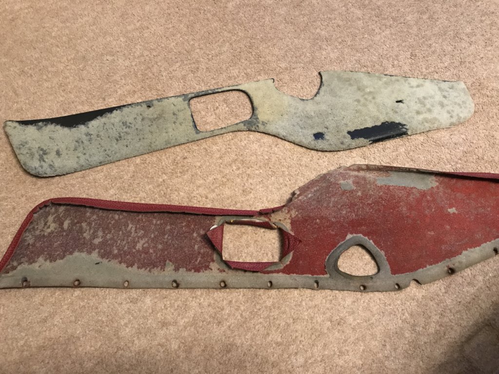

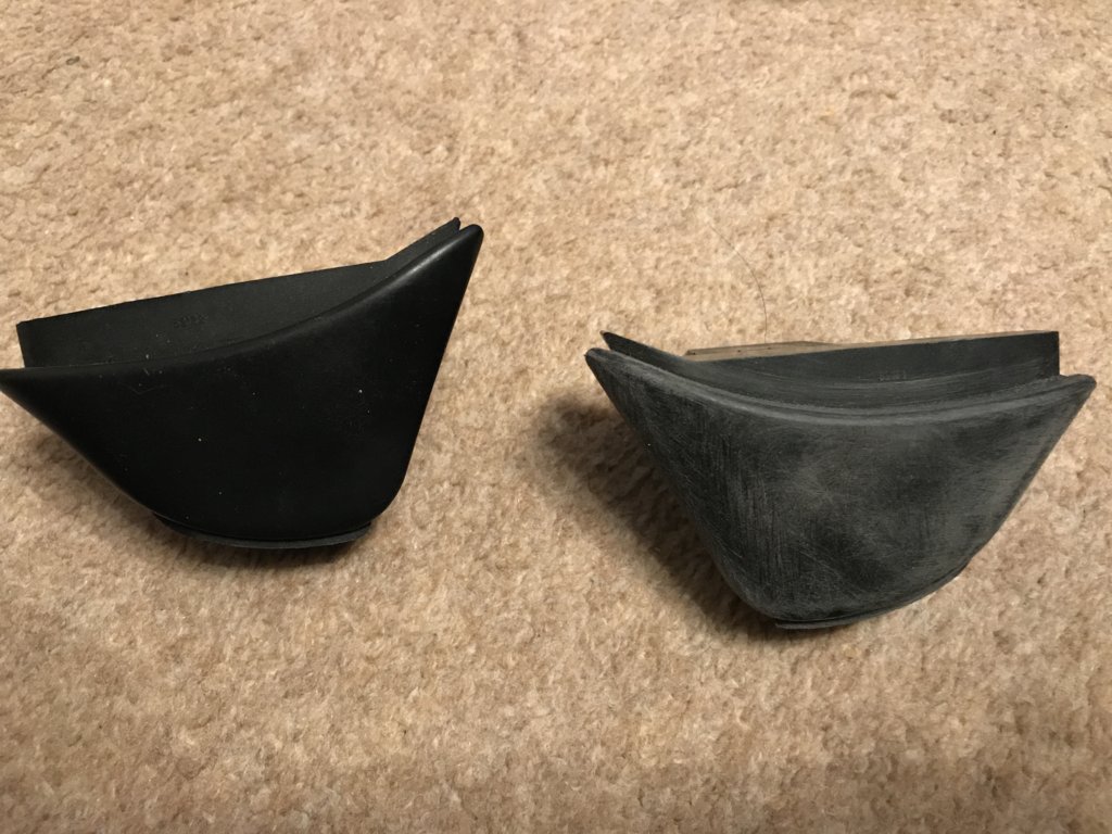

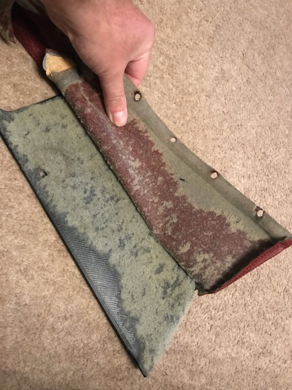

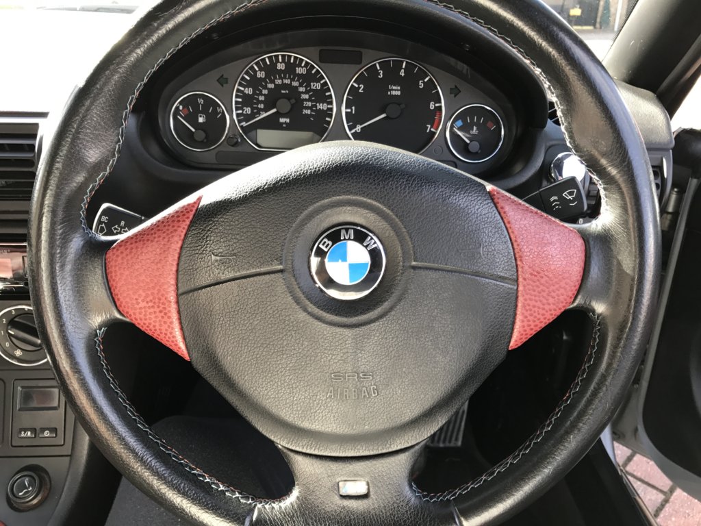

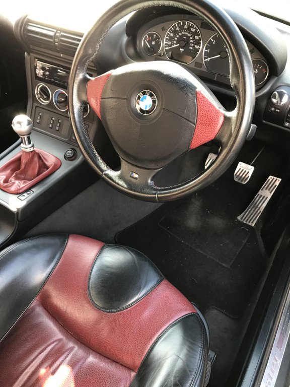

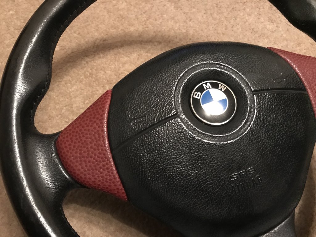

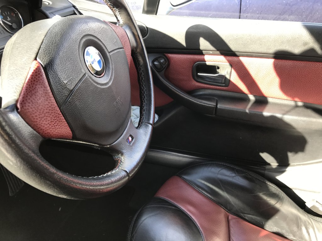

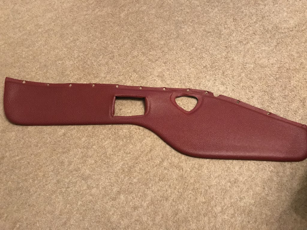

Managed to get some Oregon Red Leather from @spurs fan in a coupe, many thanks, so that I was able to re-cover the steering wheel tabs to match the rest of the interior.
I had previously covered my steering wheel tabs in some smooth red leather but wasn't to happy with the match.
So first up was to clean and condition the leather and the remove it from the plastic backing
Once I had removed it I the used a Stanley knife blade to carefully remove the foam that was still attached the back of the leather.
I then sanded down the steering wheel tabs with some sandpaper so that the glue had a good surface to take to.
I then sprayed carpet glue onto the tabs and leather backing, after left for a couple of minutes to go tacky.
I then attached the leather and stretched it across the tabs. Trimming the edges and holding in place until it set.
One finished tab compared to the original:
The finished tabs ready to be fitted to the car.
Left the tabs to fully dry, about 6hrs, then fitted them to the cars steering wheel when I got home from work today:
View attachment 65827 View attachment 65829
Happy with the final outcome and look of them. They match the seats and door cards now :cool:

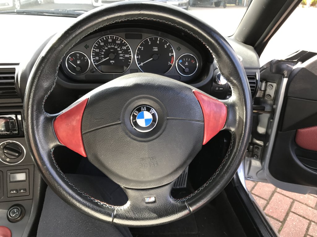

Hi Jim,
Just want to ask, as I'm in the process of getting the steering wheel tabs fitted with matching leather too, is it difficult to get the tabs removed? Any tips?
Thanks in advance!
Jjim
Jul 21, 2017
168
Mansfield
1.9 Roadster
Hi Jim,
Thanks in advance!
Really easy.
  • Disconnect battery, wait 5 minutes for system to discharge.
  • Undo 2 air bag retaining bolts on the side of the steering wheel (T27 if I remember correctly)
  • Pull air bag forward and disconnect the horn and airbag wire connectors.
  • The side tabs will then pull off.
Pulling them will require a bit of strength as they are held in quite well with the plastic lugs. Nothing will break upon removal, and they will then push back in easily after.

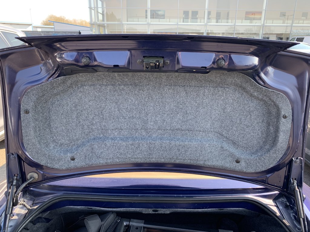

Looks fantastic, a couple of questions as a new owner please.
Where did you source the boot trim?
Springs & shocks, which would you recommend and also any disc brake upgrades recommendations for my 99 2.8?
Kind regards
Got the boot trim from BMW directly - not cheap, but at least you can still get hold of them. They only came standard on Z3M.

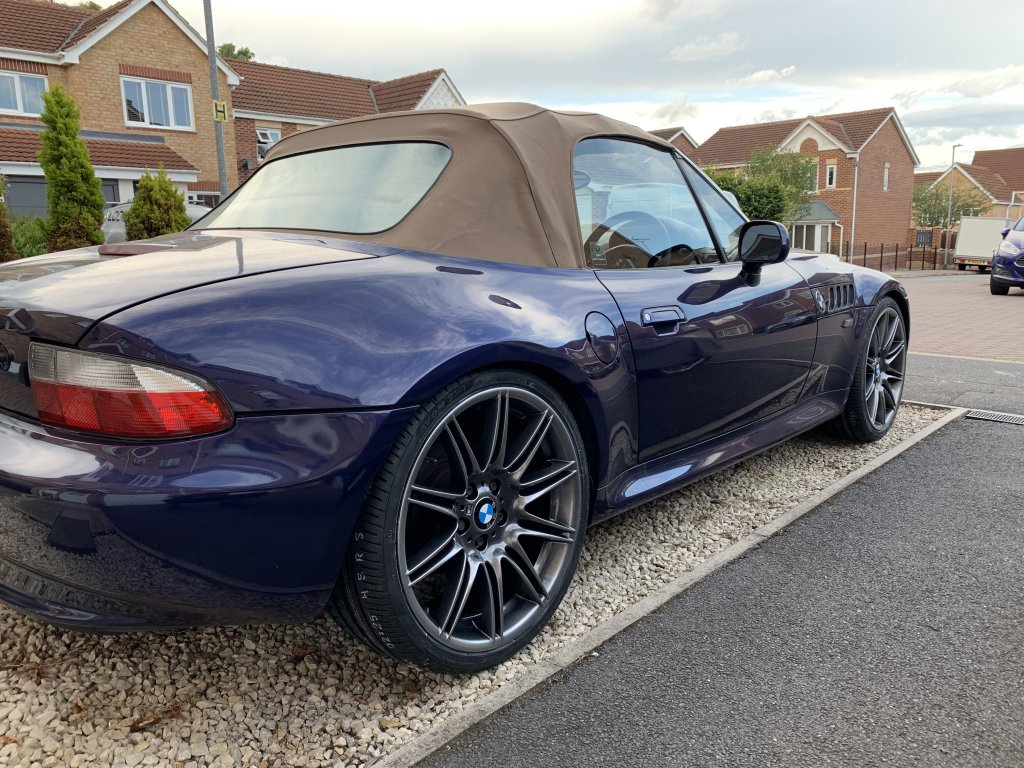

Keeping the thread up to date.
Blue’s old ones - Style 225 in peeling Silver
The new Style 225 in Black Sparkle powder coat.
9DFEA1D2-91E8-43E8-875D-D50FD954A429.jpeg F4CF4F0B-359A-4B7D-9EAF-25B50F1CD95B.jpeg EB42C8C5-2AFC-469B-B406-7B862FCE6030.jpeg FFC8D12D-BAC0-455E-9E6F-D1AEA9F1ABEE.jpeg 2E6EE04A-30A0-4269-BB25-152808697879.jpeg
