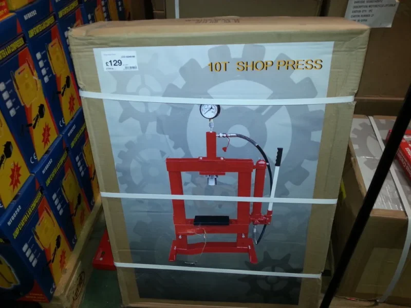

Talking of a press, I spotted this one at JTF in Lincoln this afternoon at very reasonable price and well capable of the jobs requiring the use of one.10 ton Capacity.001.jpg
Ticketed price is + V.A.T. at JTF.

@t-tony good find on that press but worth noting you will need a much bigger press to get the main beam bushes out. Nearer to a 100ton. I initially tried a 30ton myself and didnt even get the old ones out. o_O
