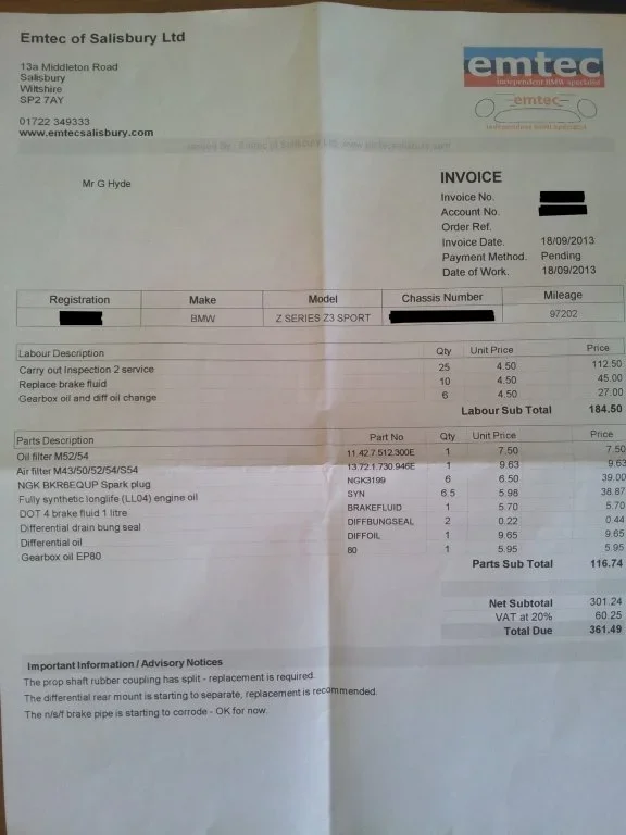

Update on the service carried out yesterday at Emtec in Salisbury. Grand total of £360.00.
  • Inspection II Service
  • Brake Fluid change
  • Gearbox and Differential oil change
I'd been concerned with the general quality of gear change and 'bumping' (for want of a better word) on the transmission when moving between gears. As you can see from the advisories, we may have found the causes.
  • "The prop shaft rubber coupling has split - replacement is required"
  • The differential rear mount is starting to separate, replacement is recommended"
Clarifying the differential rear mount after panicking that it's the diff hanger splitting, it's the rubber bush which sits between the mount and the hanger!
Copy of invoice for the work carried out.
