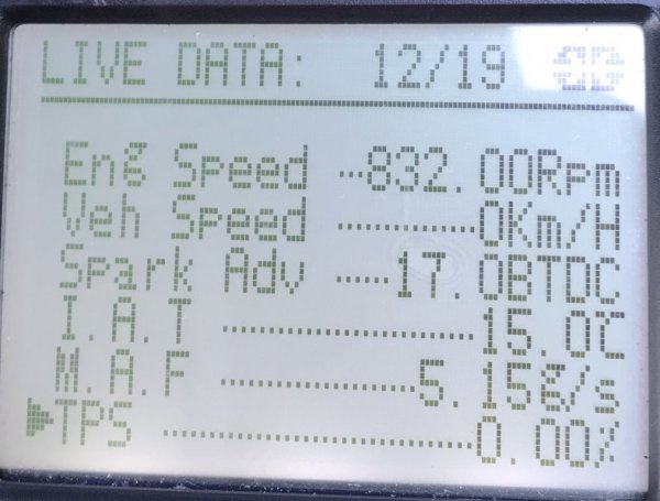

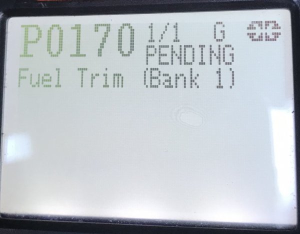

I ran the car yesterday and it almost stalled and the engine felt like it was going to just out, it was juddering and vibrating that much. I unclipped the power clip to the MAF and it worked fine.
