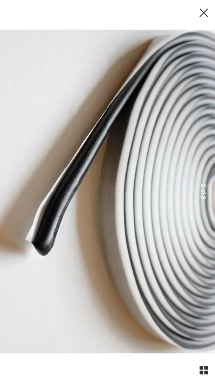

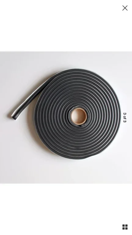

So last summer I had lots of fun with Butyl and replaced the hood to body frame seal that runs around the back of the car.
I used 2x 8m by 6mm rolls of butyl sealant bought on eBay:
https://rover.ebay.com/rover/0/0/0?mpre=https://www.ebay.co.uk/ulk/itm/182375699393
8E23560C-F2F5-472C-9B49-DDA23E94054B.png 226462FC-05EC-41E9-8C85-5C28F67B46D0.png
I ran 2 beads of the stuff around the corners where it tends to leak most.
Worth noting my car had a new hood a few years before I bought it (will check the year, have the invoice) from Carhood wharehouse and I don’t think they used enough sealant which caused it to leak again as can be seen from the pics of the gunk left on the frame, it was not much especially in the corners..
When I get a new hood fitted I’ll be looking closely at what sealant the company uses as I don’t fancy a repeat of this job!
After a second attempt (because I originally only ordered 1 roll and ran short so got impatient and bought the tube style sealant to finish the job...which didn’t work so got 2 rolls and did all again properly the following weekend) it was water tight (or so I thought).

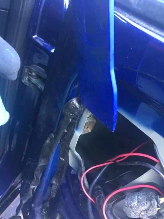

Luckily I had cut my floor carpets in sections to aid drying the car and chasing leaks so got them out again and found the leak...the bl@@dy door membranes!
The butyl had dried out a fair bit and the water was coming in from there (aided by a split in one of wing mirror base rubber seals, will get a new one..).
So I ordered more of the butyl roll and did both doors.
Top tip:
interior trim removal tools make getting trim off easy and less breaking if clips and also work well to remove old butyl:
I ran a double seal at the bottom where it leaks and used a heat gun to warm the surface before applying and then again to seal the plastic against the butyl really well at the bottom.
I actually then added gorilla tape over the bottom seal for extra good measure!
Gave the car a wash and no leaks!

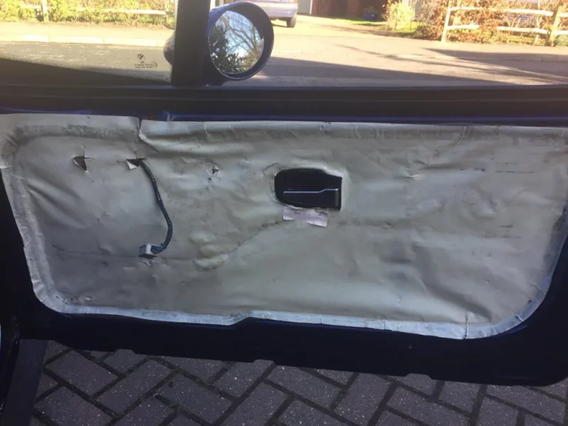

Took my door cards of the other week and there wasn’t even a plastic membrane on the drivers side! So got some plastic sheeting and some butyl of eBay and made my own.

Get a membrane on there quick! If the water drips through the right way you won’t get any in the car but if at the wrong angle it seeps in the carpet very discreetly, not making the carpet wet to gr touch but soaking it slowly underneath...fun and games!
It is just plastic sheeting so no big deal really to cut some out. In the summer I’m going whip the of and whack some Silent coat sheets on the door panels for noise reduction.

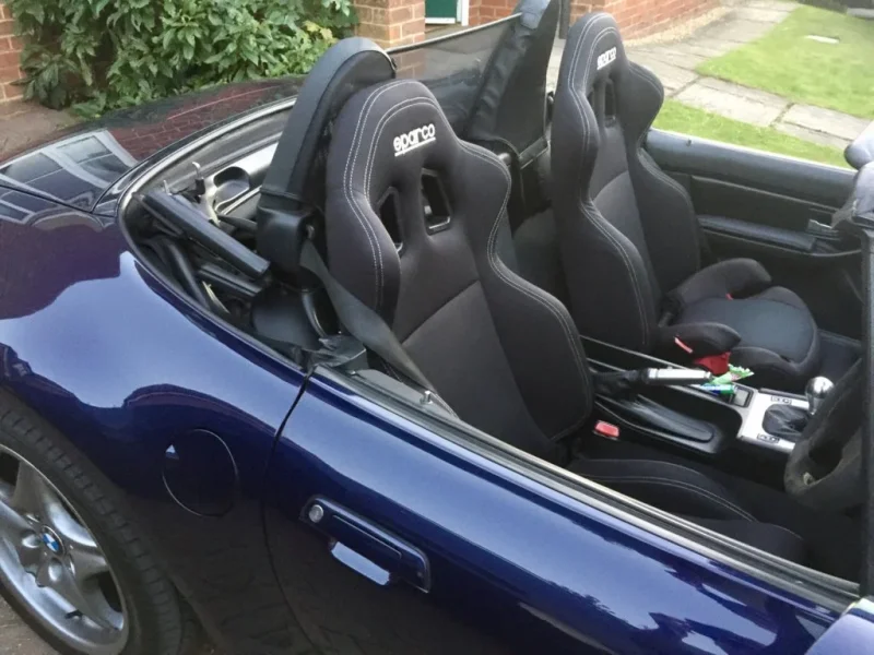

The seats are Sparco R100 on Planted Technology Z3 seat bases.
They need some fettling to get into the car (the bases). I’ve removed sections of the carpet around the sides and back of the seats to give more room for sliding back and forth. I’ve seen other build custom bases as the seat bases were actually more than seats.
The Sparcos come in different finishes. I’d like to recover the Centre section in Alcantara one day.
(The passenger seat has a kiddie booster in it! The kids actually love the bucket seat sides but need a thicker booster to see out as they a bit lower)
