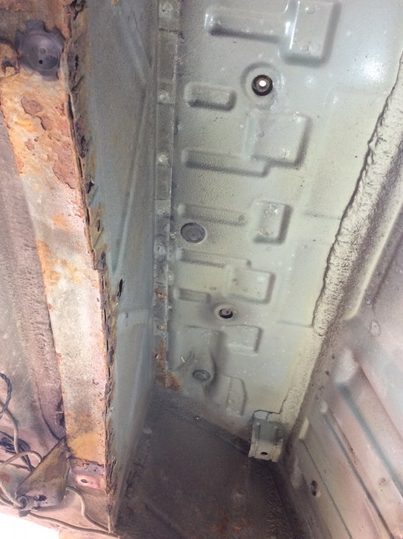

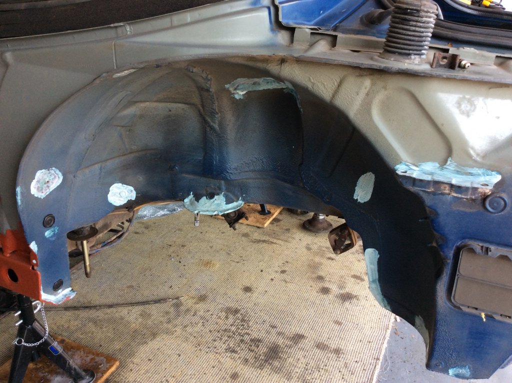

Not too bad this side ....just a bit of surface rust to treat
But not so good on other side.....
I dont think that hole should be there:arghh:
Fortunately the spring plate below is solid,
And dont think there should be sunlight shining through from the boot!!!!!
From inside the boot you can see the little hole
a little bit of MIG welding called for........( search ....mobile welders in west sussex !!!)
:thumbsup: Onwards and upwards !!!!

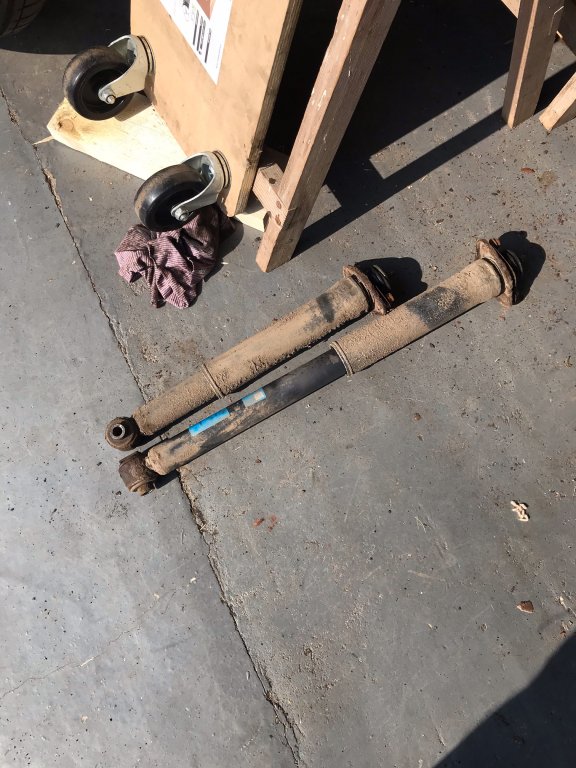

First thing I spot is the shock....overnight its expanded....great, ......might be able to reuse that one :whistle:

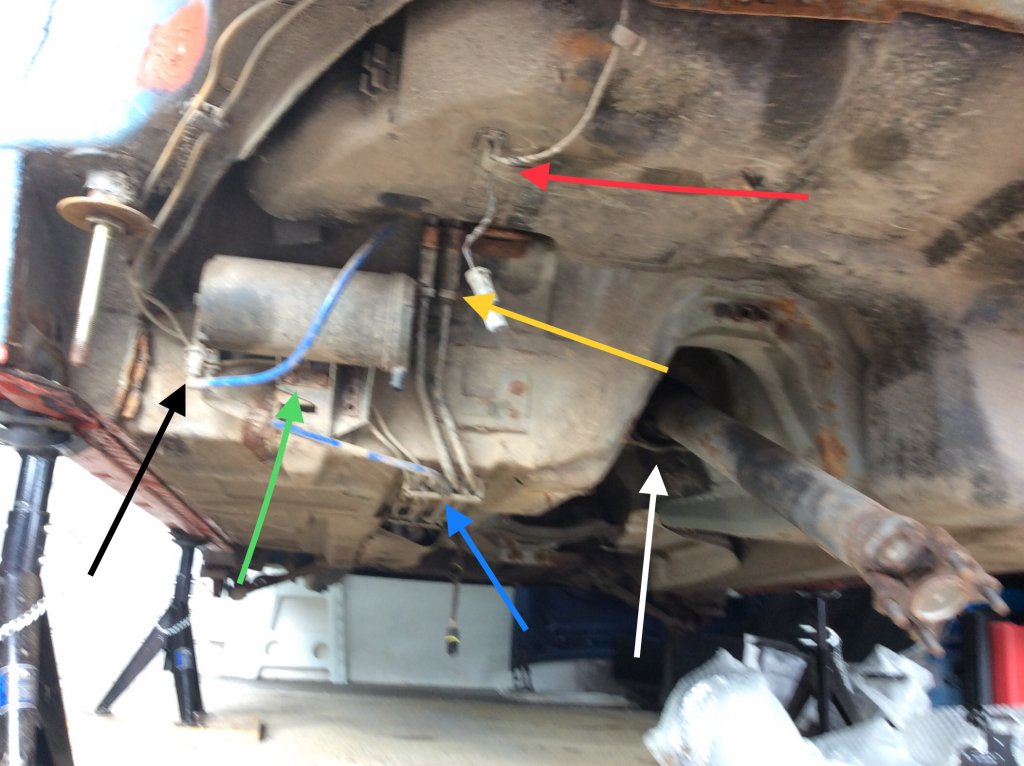

After having a general look see underneath......I don't know what came over me........I thought to myself.....that would be a good idea....and unfortunately there was no one around to say ‘ you dopey sod, don't take anything else off ‘ .........so if you ever get to this stage and you are as dopey as me............here is a ‘how to’.....as in remove the fuel tank........:bashhead:o_O
Firstly.....
Inside the car, undo the four screws that hold the panel and disconnect the plug. The outer part of the plug slides back which then allows the plug to be pulled off
Then remove the rubber gaiter from the neck of the tank....
Then underneath........
Red arrow......disconnect the wiring
Black arrow disconnect the line from the filter ....pulls off but bloody difficult ( there are two o rings that may need replacing)
Blue arrow. Take the cover off to allow the pipes to be dropped down. It gives more room to disconnect from tank lines
Yellow arrow, disconnect two jubilee clips, and pull the joints apart. There is a bit of fuel loss but nothing much.
In hindsight, at this stage I should have undone the two bolts that hold the filter ( green arrow) and gone underneath and unbolted the centre support on the propshaft. ( white arrow)......its easier if they are out of the way.....( I moved them after realising The tank was stuck :whistle:
Then the main bolt.....
Then it falls on you.......=))
