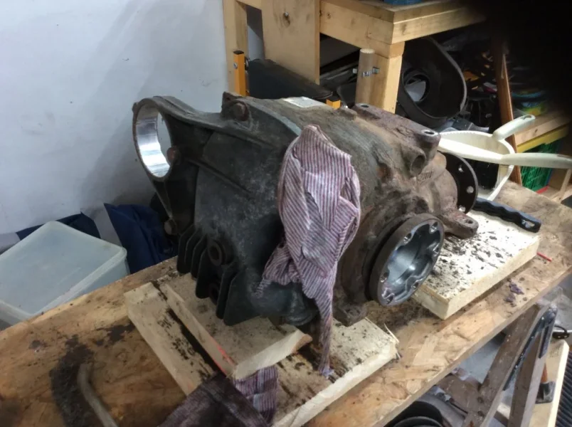

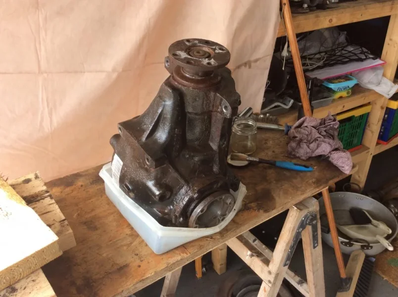

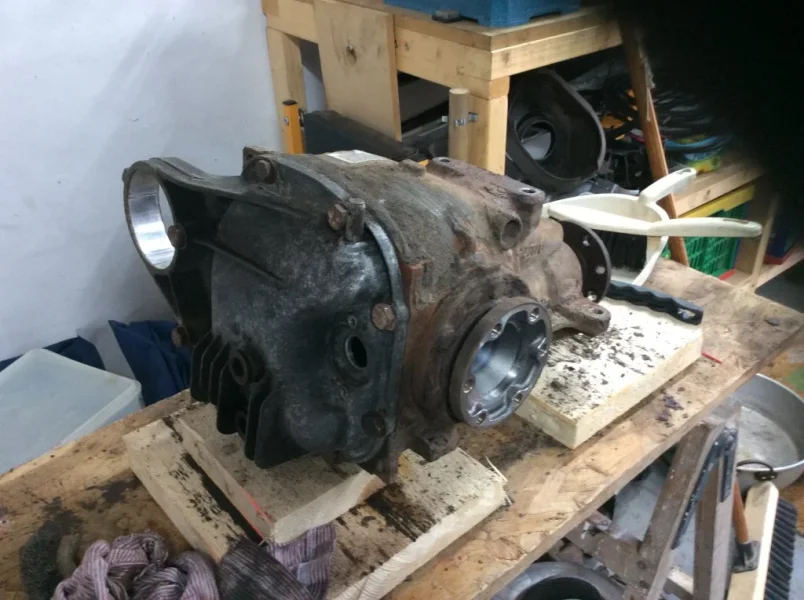

Another day....and a bit more cleaning....
One scruffy looking diff....
Two hours of rust flying everywhere later...
Sitting draining the last of the oil out, and with the rust treatment drying.....tomorrow it will get a coat of high temp black paint.

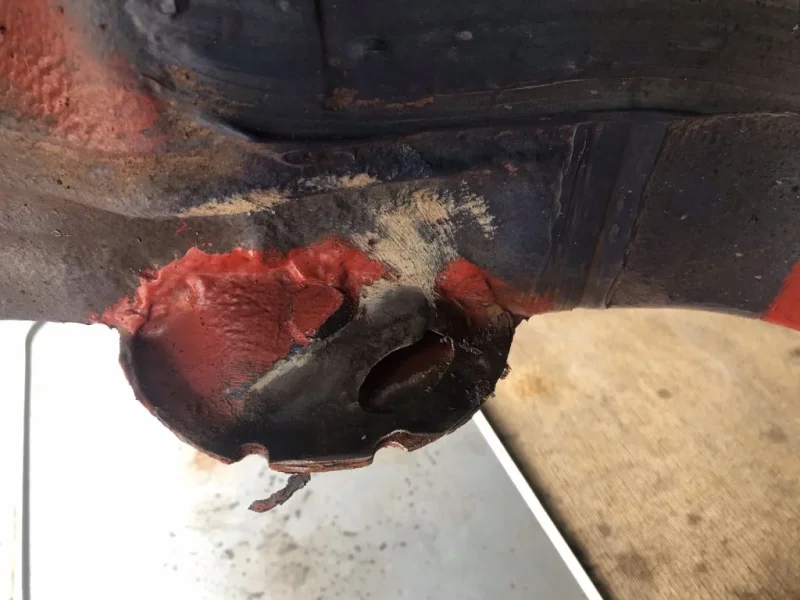

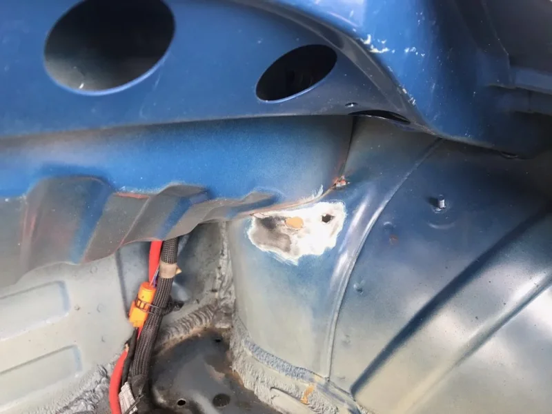

Hole.. :arghh:
Bigger hole.......:arghh::arghh:
No Hole...:):):)

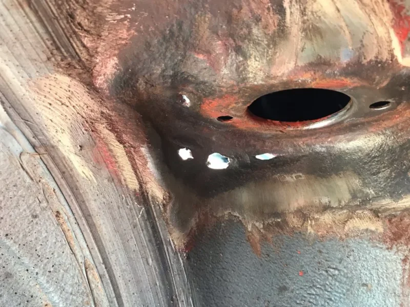

And the small holes up by the shock mount also sorted..
By firstly cutting it all out......made an insert piece....
And all solid again....
Red oxided , then some paste was put on to fill the seam. Hence it went pink !!!! I could repaint the car to match:whistle:
( it will be blown over with a rattle can later, when I get round to finishing the underneath)
The guy who did the welding was really good and definitely will go on my speed dial list:thumbsup: Thanks to Mark,( @Althulas) for finding him on FB for me.

Hole.. :arghh:
No Hole...:):):)
