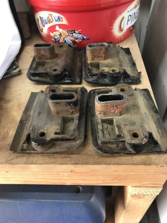

and the jacking points had no fixings at all in any of them…. But as underneath them had been red oxided I must have removed them two years ago…. Dont remember doing it… but then I can remember if I had breakfast today =))
Bit of black gloopy , insert the anchor points and after the jacking pads have been cleaned they can go back….
