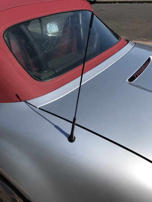

Spent most of the day in working in the garden as trying to make it easier to maintain !!!
But was thinking that I have been neglecting the 1.9 so I will do a few of the advisories over the next week or so…

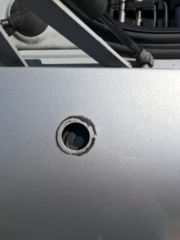

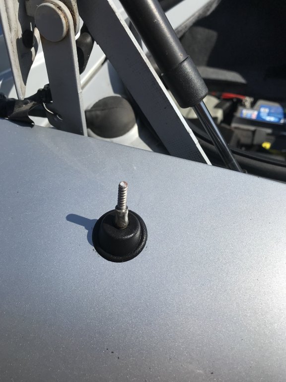

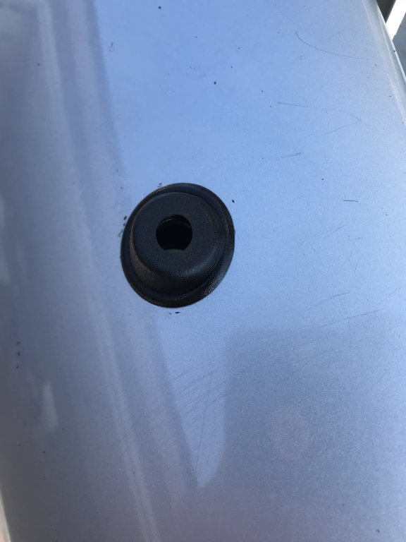

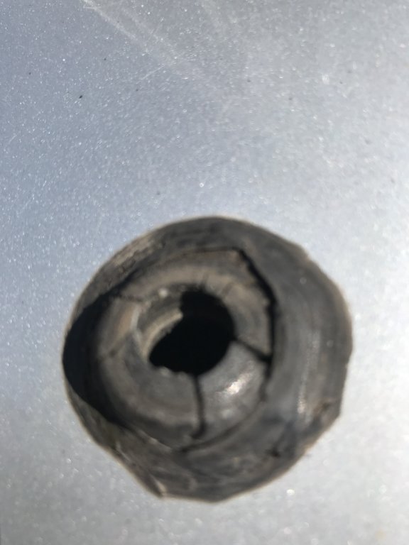

Not an advisory , but something I have been meaning to do …. The aerial grommet.
surprisingly not leaking… but cracked and sealant all round it ( like it when I got the car)
Bit of spannering in the boot and aerial removed. And grommet just fell out
So a nice ring if sealant to remove!
Bit of meths and a soft cloth and it cane off.
Then sprayed the grommet with silicon and it went in really easily
Same thing on the aerial and pushed it in from the boot and again no problem.
Just a case of refitting all the stuff in the boot and screwing the antenna back on
One job done !! =))

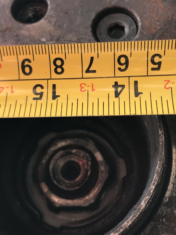

Just taken measurements from the sill to the centre of the hub
Passenger side
Drivers side
so it would appear the trailing arm is bent, and the hub is not square to the mounting bushes…….so £450 down the f*****g drain :eek:

That's a real heartsink to say the least! ( other more expressive words may be more appropriate!) But you know what the problem is & a man of your calibre can fix it. You can't give up now & fall at the final hurdle.
