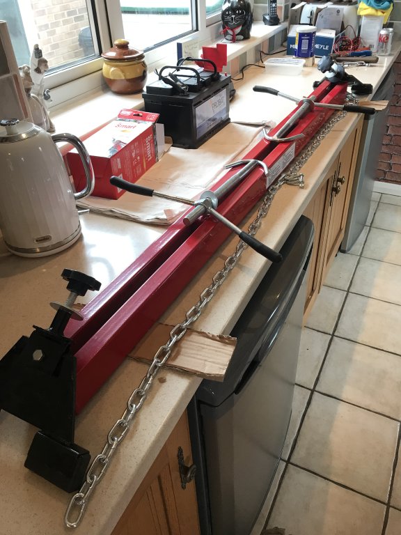

But I did play with my new bit of hardware…
I need to get a bit more advice before disconnecting anything…..
Might try and loosen off the 4 engine mount nuts tomorrow…… dont think it will go anywhere if I just do that:whistle:
I am thinking of putting the chain round the engine mount brackets…. Unless someone can tell me if thats a bad idea??
The far side is clear to do it , but the nearside has a couple of air tubes to remove first so the chain doesn't put any strain on anything.
Seen an engine support used at Zedshed HQ ….. and looks really easy ….. but ….. bloody scary when you do it on your own=))

Advice on the engine support means I can set it up tomorrow and hopefully drop the front beam
Picked up a strap, 1tonne capacity from Toolstation , so it can go round the sump and the chains up the sides of the engine.
Also going to put a safety line on the front lifting eye.

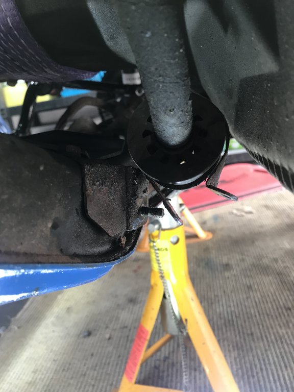

but…… after removing the engine mounts, which were a bit worn, but not as much as I was expecting. I found fatigue cracks on the subframe underneath the mounts.
If I were to tap that clean area it will just drop out:arghh:
The other end is not quite as bad but shows signs of it starting to crack.
the only word that came to mind ( after the obvious one=))) was ‘scrap’
So bit of a pain , but glad I have found it so it can be sorted.
Just need to find one and then refit it all.
Plus the job was not as scary or as difficult as I thought it would be:thumbsup:

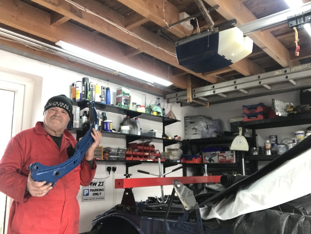

And just got a front subframe :thumbsup: :)
(Off a 2006 316i.)
Its the E36 standard part as used on all Z3’s and series 3 cars
Part number 31111096485
And one more bit of scrap for the metal goblins =)) =)) =))
Wish I hadn’t bothered to paint it now :banghead:
