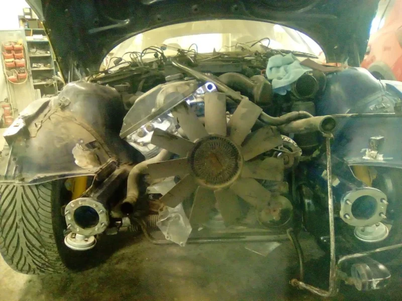

Had a busy day today,
Got the rest of the front stripped, didn't have a 32 mm spanner for the fan so old school ways deemed success :D
fitted the new water pump, (old one was a tw@ to get out and had to use a slid hammer) also fitted the new stat and housing, I have decided against fitting a tensioner but have the idler on order,
I stone guarded both chassis rails as they seem to take a bit of a hammering and painted the N/S inner wing and finished with satin top coat
