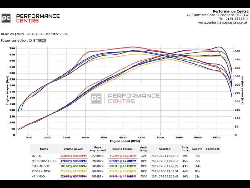

I thought the mark 1 version was making 500bhp+?First version is the 2.8TU. Reason behind it was the few HP from a M54 intake manifold and basic mods were not enough.
2nd engine is 3ltr M54 with all new internals. Forged rods, pistons, upgraded oil pump and so on to ensure reliability. Reason for this is simple addiction, 400hp doesn't seem enough.
Thnx for the feedback…my 35is is now around 525-545 crank BHP and 750 nm torque ..on 23 psi tapering to 21 psi..with a Quaife lsd and all the Nannie’s…if you let it rip it’s almost mind bending….so I look forward to the Z3 with even more powerMk1 is 425hp. It could make more but the stock bottom end is more then questionable at that figure.
The boost controller failed on one of the Dyno runs and it made a lot more power and we were all surprised it was still in one piece after seeing 2 bar plus of boost. Mk2 won't have that concern and the new turbo will come on sooner so even better.

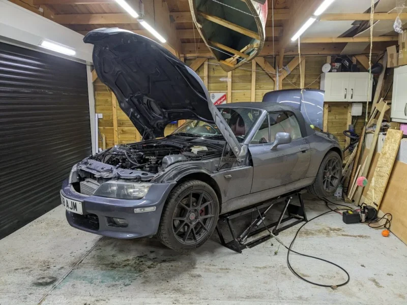

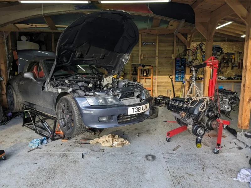

Port injection Zeds run a lot cleaner than direct injection Zeds..the N54 is notorious for coking up its inlet’s..the later N20/N55 had better control of the recirculation system so wasn’t as bad…Today was engine removal day. I have worked on this car far to much. From the point it was lifted off the ground it was three hours until the engine was out. Will take a whole lot longer to fit the new one with all the changes.

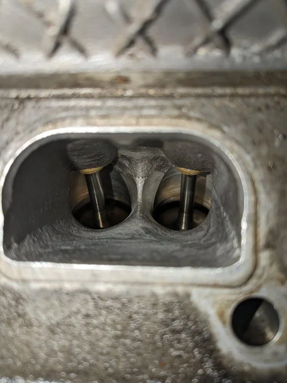

I was very surprised at how clean the intake valves were. The stock crank vent system was removed when the turbo went in and it catches a lot of moisture and filth. Intake ports are spotless.

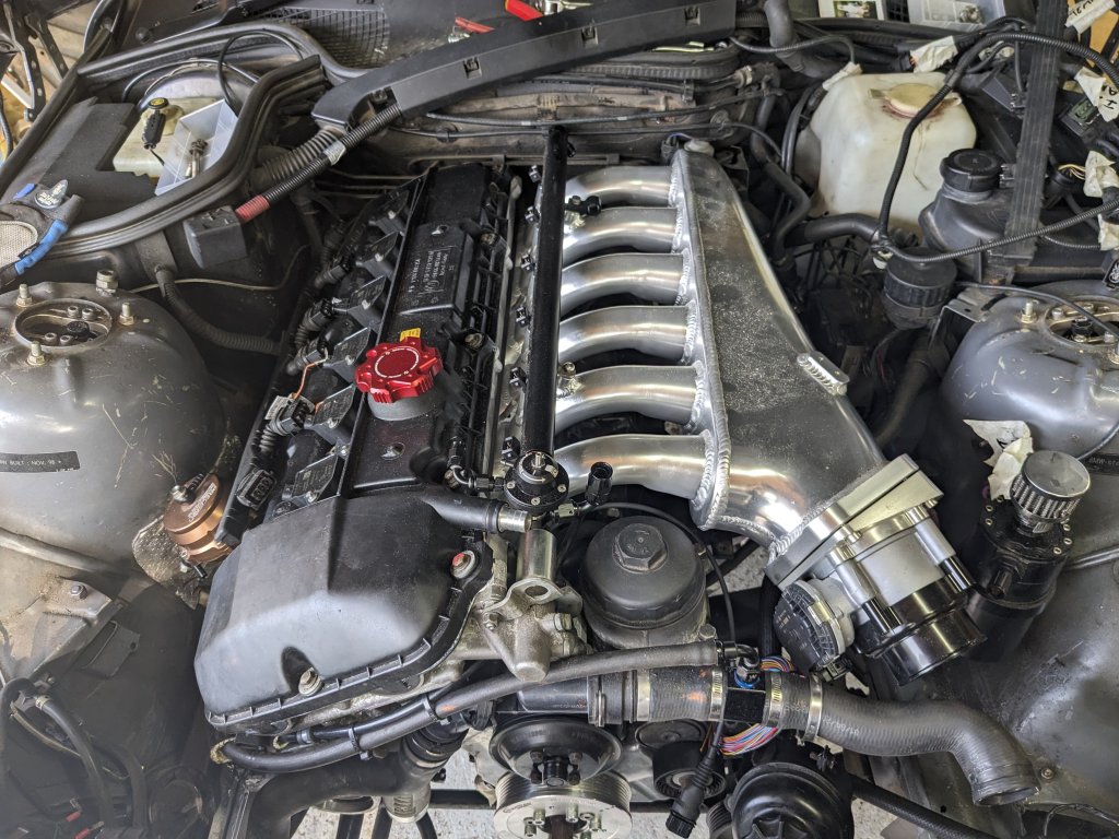

This project all started when I picked up a 330 intake manifold for more power. The more I thought about it I didnt think the amount of work was worth the return so I went further.
It was a steep learning curve but worked out in the end.
The MS43 DME running the TU engine is not supported and nobody modifies them so I had to go with a standalone. Everything works as original but I lost the traction control. I will talk with the tuners as I maybe able to wire this back in.
The other I experienced was my fault. I didn't remove the block from the car and choose to tap the turbo oil return into the boom right of the timing cover. This works on top mount turbos but my low mount didn't drain. Car smoked like it was in a 007 movie. In the end I fitted a scavenging pump to return the oil. A little noisy on startup but once the oil is warm its fine.

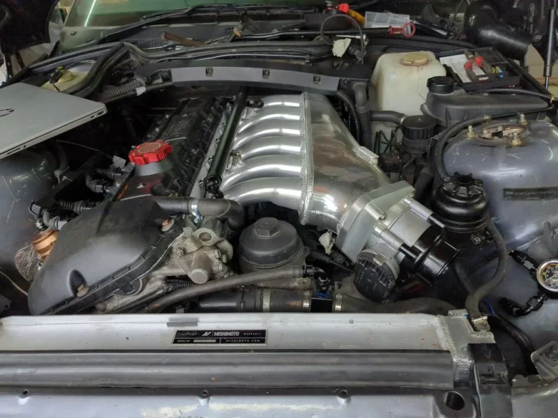

While she recovers I managed to get the new engine in before going away again. Still a lot of work to go as there are so many changes.
The intake clashes with the heater control solenoid and the power steering reservoir needs to be relocated amongst many other things.
