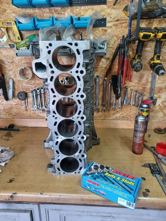

ARP 11mm head studs for the S54. Will also machine the block for thread inserts so they dont pull out of the aluminum.

It may not be pretty now but it has been drilled out for inserts to fit 11mm ARP head studs.

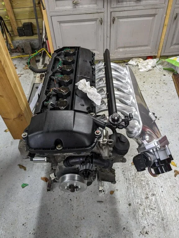

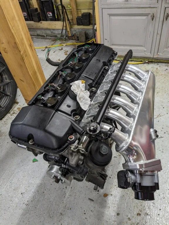

Just ordered a Bosch 82mm drive by wire throttle body. Already picked up an electric pedal assembly so I'm all set. This will eliminate the idle control valve and make tuning easier.

Changing to drive by wire to get rid of the idle control valve. It will also have some tuning benefits.
New intake fitted, will require relocating the power steering reservoir.

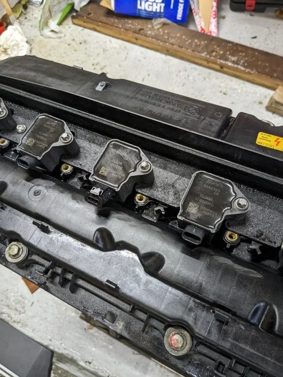

Made a new bracket to fit B58 ignition coils for more spark. Will finish the wiring loom shortly.
