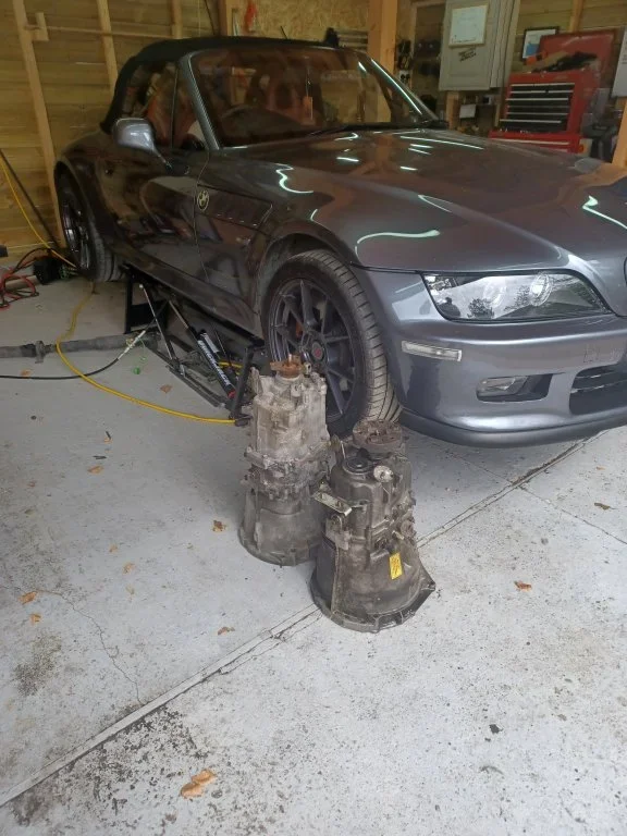

Z3 2.8 real widebody
I'm collecting parts for the next step.
I already have a six speed gearbox from an E46 M3. Now I have a twin disc clutch to go with it.
Currently I'm running a DKM clutch and the pedal effort is just more then I like for a daily driven car. Works well and holds the power but just heavy.

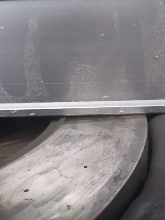

Been awhile but the car is making 425hp and running great until today.
Went to a local car meet today and and on the way home the clutch started to slip. Its an uprated DKM clutch but not good enough.
I have a 6 speed box and dual plate clutch to fit so I guess I will be doing that sooner then later.

Clutch cover is completely warped. The disc is concave and there is over 1mm clearance on the inside. Besides that it generally looks horrible.
