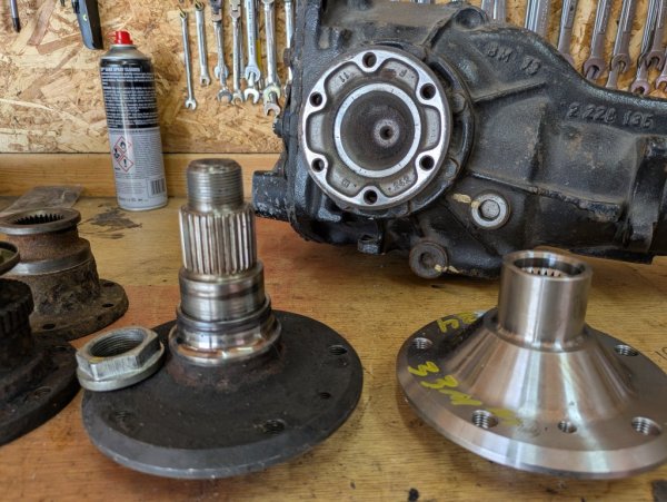

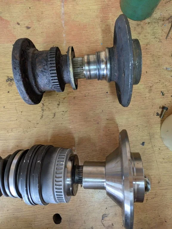

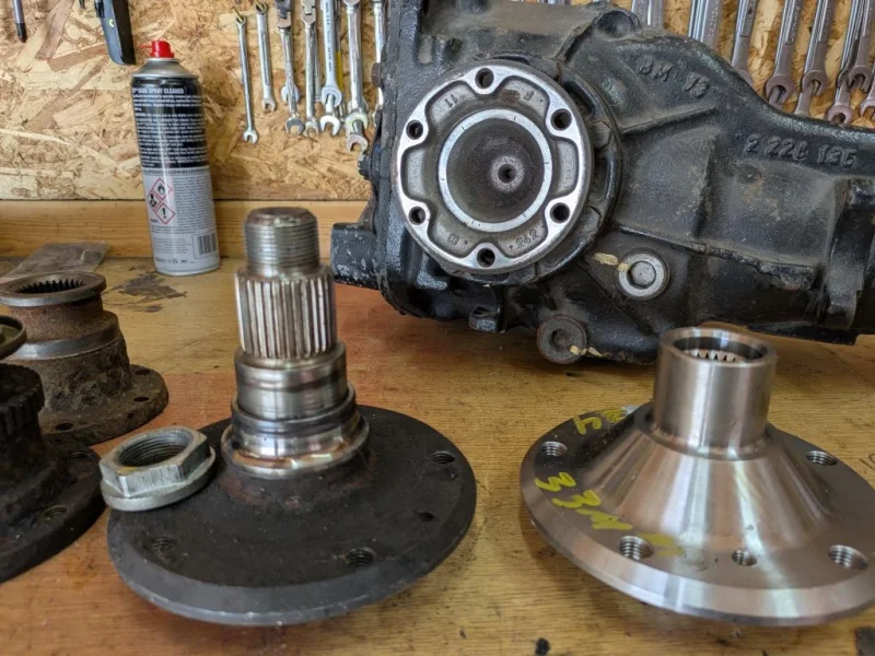

Started collecting parts for the next upgrade. I want to increase the strength of the diff and cc joints. Already lost one joint.
I have been doing research and have an E36 M3 Evo 210 LSD diff and E32 drive flanges.
Diff will require a 4 bolt input flange and custom mounts. The E32 flanges have a 42mm shaft so fit the bearings but use an inner adaptor flange that the cv bolts to. Stock is around 29mm splines and the E32 are 36mm. This also allows for bigger 108mm cv joints. Will require a little machining to fit the original ABS sensor ring and to get it all to fit.
Fingers crossed. Still need to do some more research and figuring out but I think it will all work.

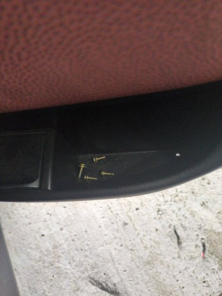

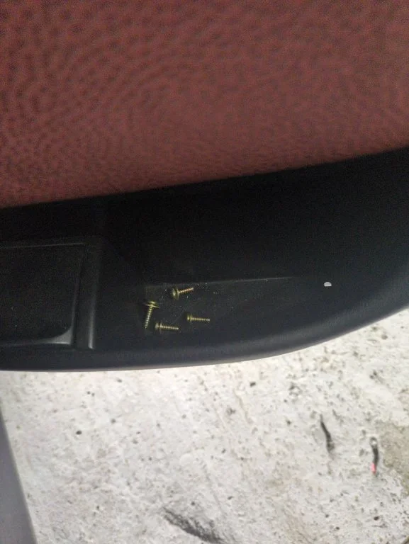

You know it has taken to long when you spend an hour trying to find the screws for the fuel pump cover. Was pretty sure I through them out with the stones and jelly beans when the seat we as removed to access the pump. Just as I was bolting the seat back in I found them safely in the door card pocket.

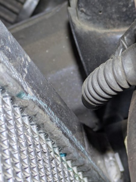

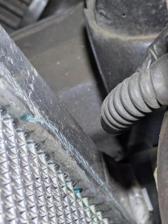

I have been worried for a bit as there has been a small blue wet patch on the garage floor for sometime now. Really tiny leak and I feared it was the common issue with the cut ring head gaskets used for high boost. The steel rings sometimes limit compression of the normal gasket part so they weep a bit of coolant.
Either way I got a radiator pressure test kit as I could not find where it was coming from other then the right frontal area of the engine. It is just where the head gaskets normally leak, cooling lines for the turbo and half of everything else I jammed under the front is located.
Turns out the Mishimoto radiator is leaking at the core on that side. I have heard they dont have the best build quality but its the only larger radiator I could find. They have a lifetime guarantee so now I get to see how well they honor that.
I maybe jinxing things but I am amazed at how well the car is running at this power level. I drive it daily and its been up and down the country without missing a beat.
Mishimoto Don’t have a great reputation…their Chinese manufacturers seem to not so good as others’ Chinese manufacturers are…
