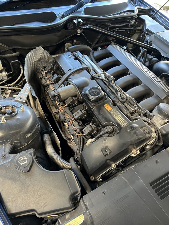

Now the coupes back in my ownership I’ve already begun doing some preventative maintenance. I noticed last weekend when fitting some new plugs cylinders 3/4 had quite a bit of oil in them, so I ordered a rocker cover gasket.
Flying solo today
Valvetronic removed
rocker covered removed
in all her glory
Not to shabby at all for 146k and some 20 track days under her belt.

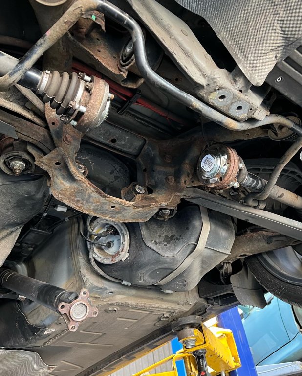

Finally got round to dropping the diff today. Straight forward job removing on the z4. Get the exhaust and under trays out the way first. Unbolt the drive shaft with prop shaft. Disconnect the roll bar and unbolt the diff. Tilt the whole diff backwards and she falls out.
Some snaps from playing today.
various bits disconnected
tool of choice for lowering.
nice big hole, she’s not bad for 150k miles at all
the open diff gears
I’ll get some photos of the new unit installed.

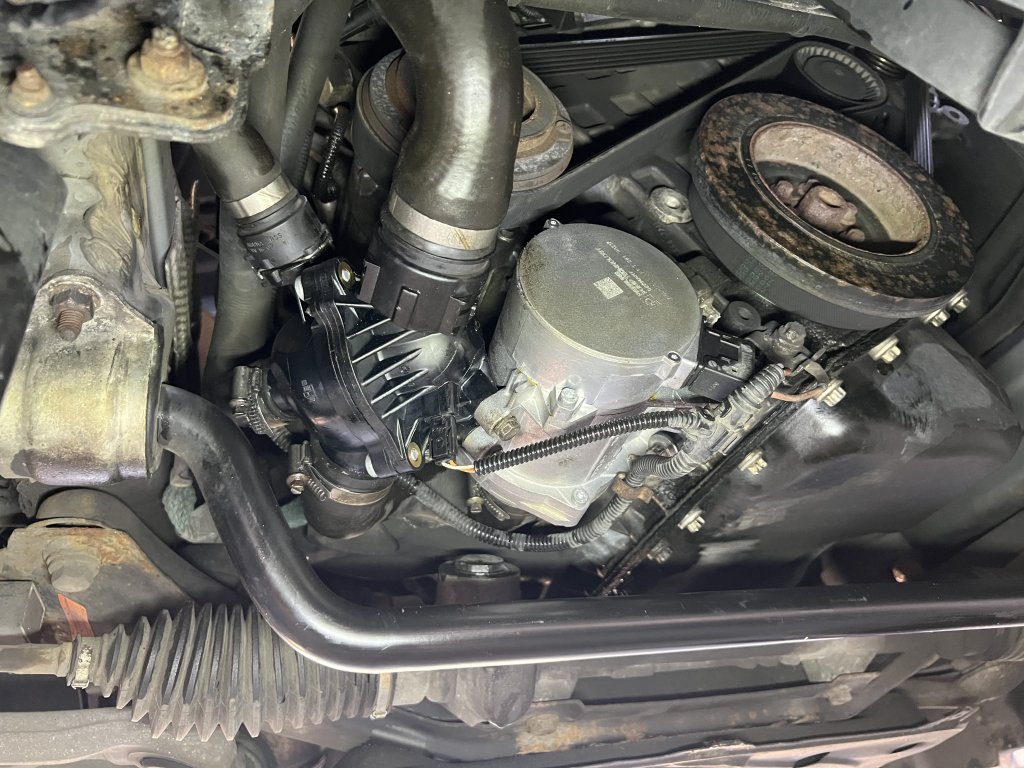

next up the starter motor died, it screamed so loud when it gave up I thought something was in the engine bay. So a Lucus replacement bought from Euros that same afternoon. Luckily with the black top N52 engine you can fit them without having to remove the inlet manifold, if you have a silver top your PCV system will be in the way.
the Shenanigans didn’t stop there, I was getting some strange spikes in engine temps. We’ll aware this water pump is original this will very likely be the culprit. With the water pumps you can’t skimp due to it being Electic. I bought an OE pierburg pump and Meyle thermostat. Didn’t want that failing any time soon.
Looks like a turbo :D
under trays off to show the pump & thermostat.
only took an hour to swap over, notice the new design is plastic over alluminium
she’s looking tidy still for 150k
