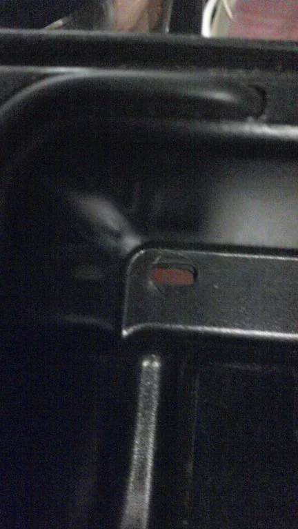

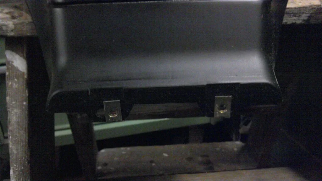

Hi Geoff, the cubby box only has 7 screws holding it down, 3 at the back 2 inside and 2 at the front. The 2 front ones are hidden by the centre console, to get at them you have to remove the three screws on each side of the console, remove the ashtray and then its carrier which is held in by another screw, under which is another screw holding the console to the bodywork. Then you can lift the back of the console a couple of inches to gain access to the 2 front screws of the box. You can prise out the alarm led unit to see and maybe access these front mountings but at the risk damaging the tabs that hold it in. It should take around 40mins to get the box out.
Once out you can then remove the turrets covers and drill the holes for the roll bar fixings with a bit more accuracy. Make sure that you fit the torx bolts in a couple of threads on the turrets before replacing the covers, if you try to put them in after you have refitted everything, you are at risk of losing one and having to rip it all out again to find it.
Here are some pics that might help.
Back fixings
Front
Inside
Turret cover
