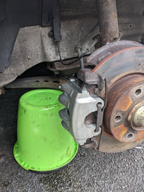

I replaced the problematic one!
It looks fine but I get an air sound from my brake pedal. So according to Google something is leaking. I didn't lose much fluid and I let some drain through the valve on the new caliper.
The brakes seem to be holding the car fine when I take off the handbrake.
Any tips?
Thanks!!!
is that just the servo air, if so that is normal?
Switch the engine off, press the pedal a few times and the sound will disappear as you use up the reserve of air. the pedal will also get harder near the top.
Keep you foot on the brake pedal, restart the engine, the pedal will go down a bit as the servo refills with air, switch off and see if it does the same again.
if so all is normal and good with the servo.
PS like the green axle stand, is it a 1 tonne or 3 tonne rating?....:whistle:

PS like the green axle stand, but wouldn't trust it much....:whistle:
It is a caliper stand 😂
I have tried doing that. When I switch off I press the brake pedal and it gets hard without air noises. But when I start the engine I get air noises again. I may try holding the brake when starting the engine. At least they work fine. Went for a drive and it stops ok.
