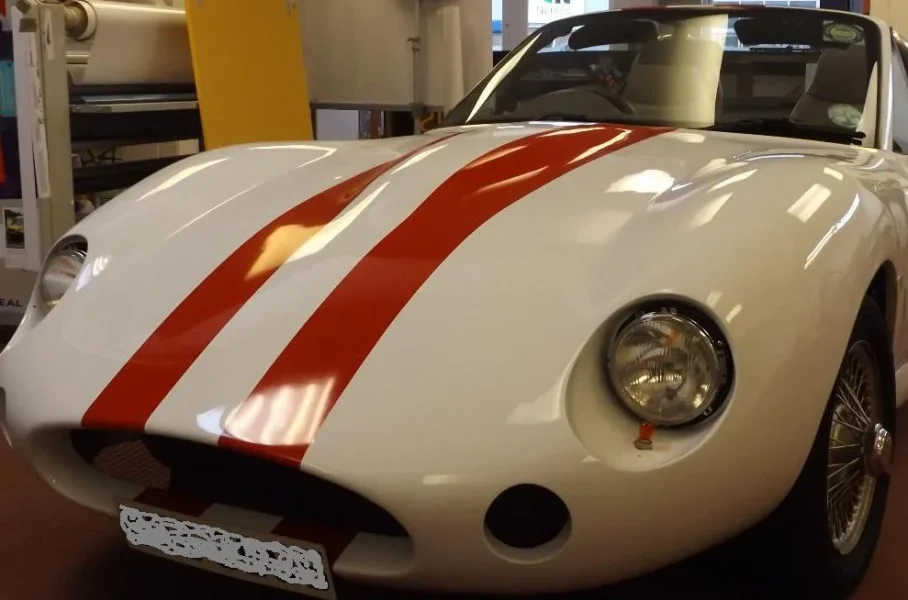

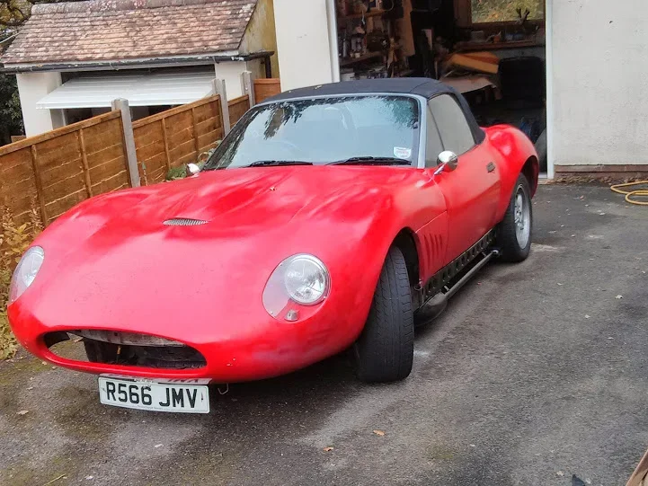

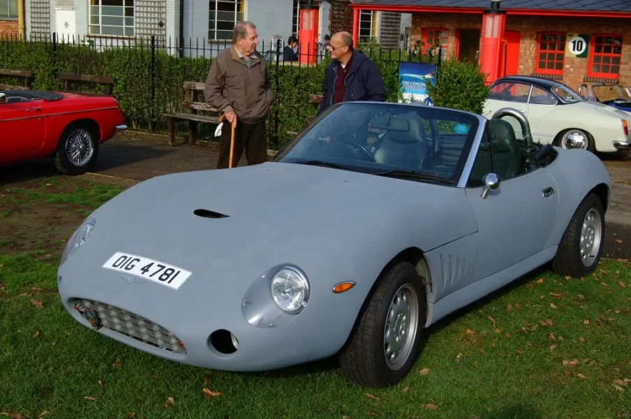

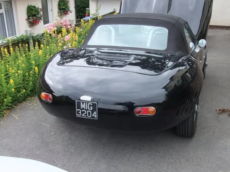

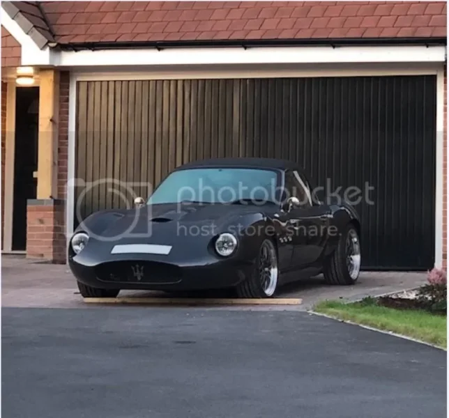

What colour for this one? Some previous...
